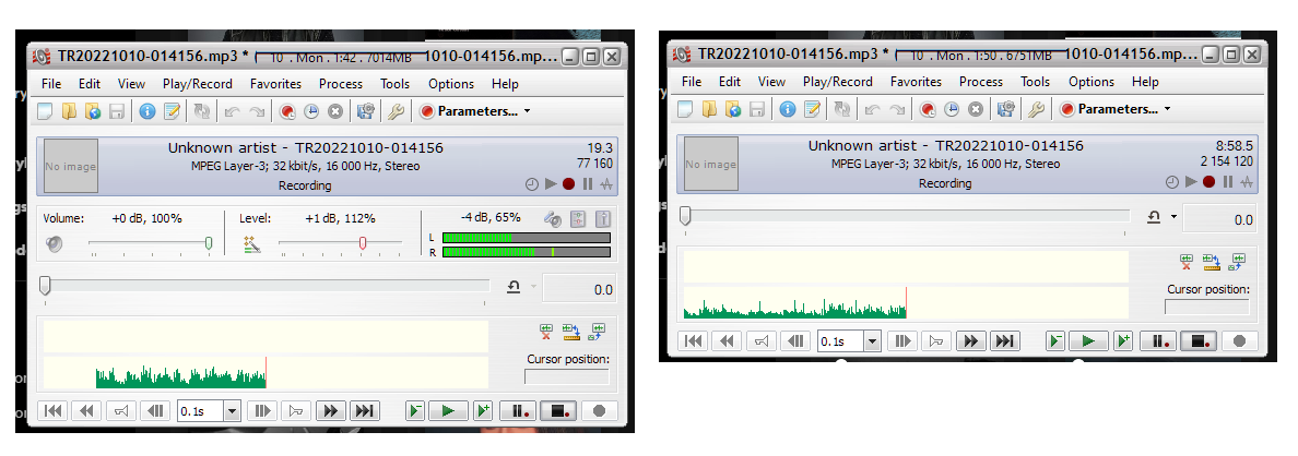

Re: Any experience feeding VM's B1 output to TotalRecorder?
To finish out this topic, for anyone interested in using TotalRecorder with VoiceMeeter, here is the solution I found. It works quite well.
I have used TR for years and like its simple, clean interface for recording (the displays are quite small) while I am on calls or zoom. The 'View' menu allows some features of the GUI to toggled on or off. The problem on the left is that clicking the level slider crashed TR when used with VoiceMeeter (left screen shot). In the right screenshot I have turned that row off, and in this configuration TR is stable.
In doing this I lose the stereo level meter on that row, but there still is a progress line showing the overall level of the two channels combined (although the recording is still in stereo). Importantly for me, I still have the time count in the upper right of the blue pane.
