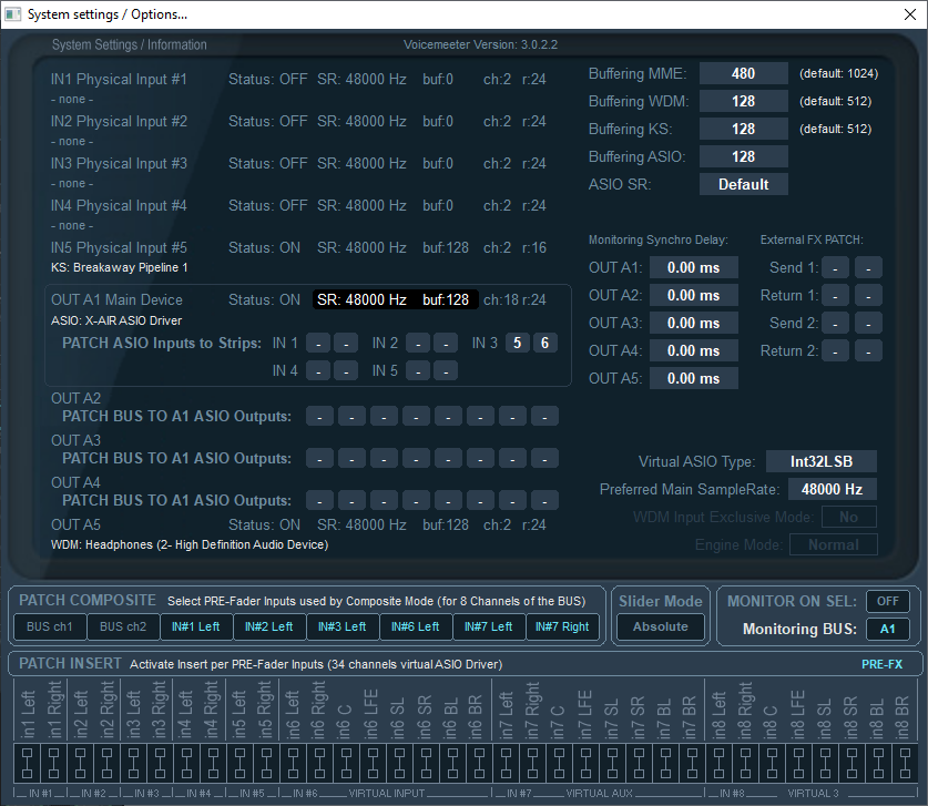

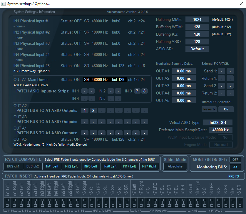

VM System settings
VM System settings
System settings.png (113.9 KiB) Viewed 13589 times

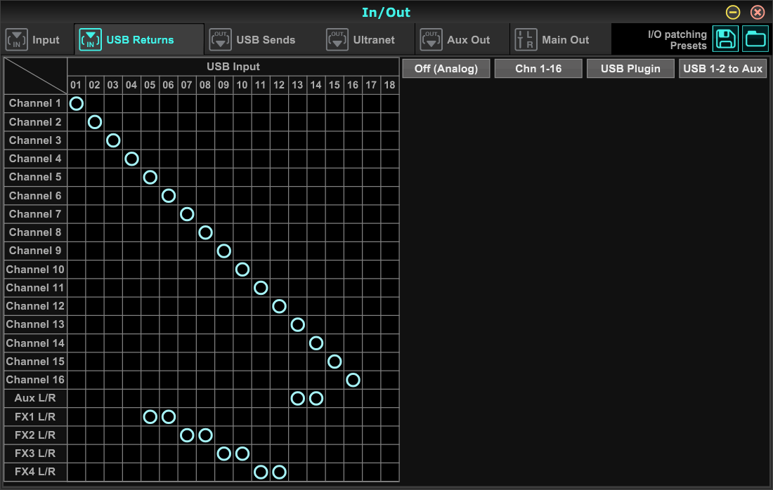

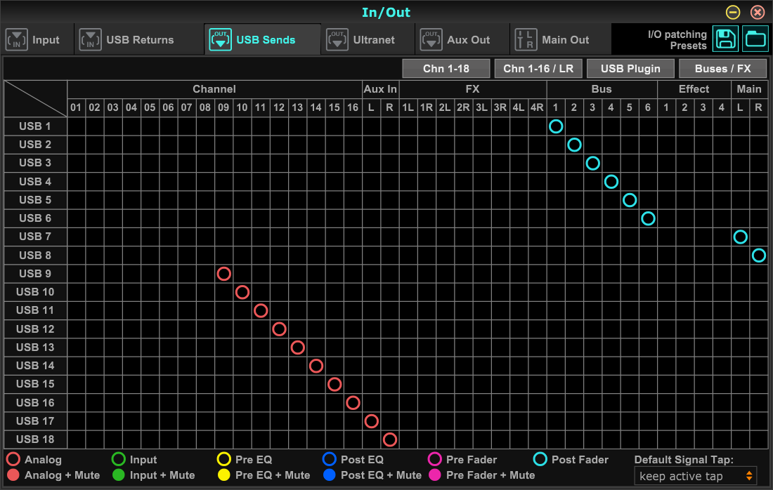

The XR18 air, a 'mixer rack', used as USB audio card.
Using AUX3 in this example
XR18 air.png (209.63 KiB) Viewed 13589 times
Sending AUX3 to asio 5 & 6
XR18 air ASIO sends.png (92.09 KiB) Viewed 13589 times
Input to mixer from cannel 1 & 2 / A1
XR18 air ASIO returns.png (82.33 KiB) Viewed 13589 times
