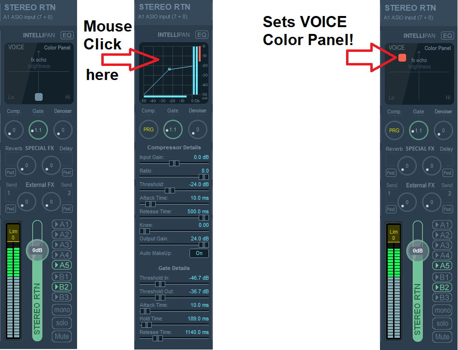

-When in the Compressor/Gate details window, clicking the Compressor/Gate view still sets the underlying effect (modulation/voice/postion). Odd

3- Don't understand your remarke : "clicking the Compressor/Gate view still sets the underlying effect"

3 -> See the image below, hope this explains it. 4 -> Nice one, cool. Thanks!
