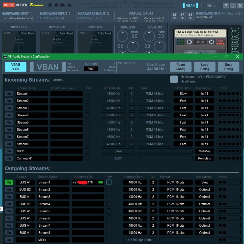

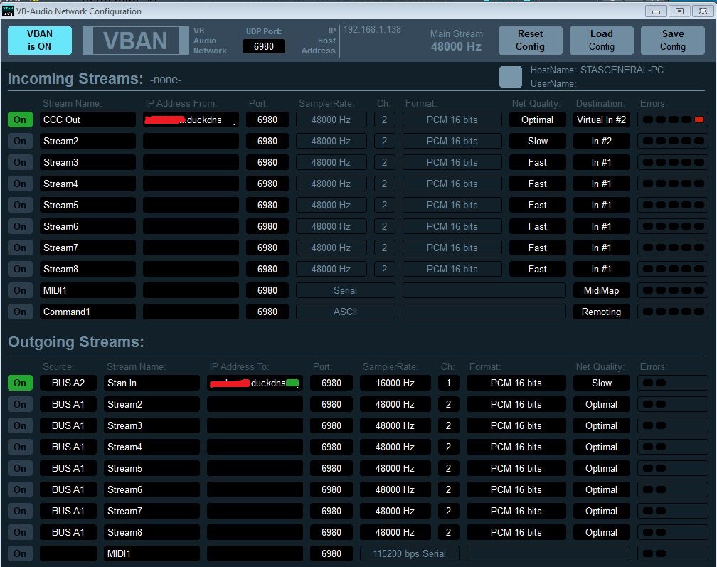

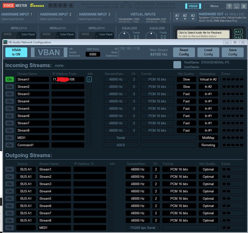

ok, so in this case, you may post screenshot of your VBAN Dialog box for both points to let me check your VBAN configuration.
- Posts: 11
- Joined: Mon Nov 21, 2022 2:08 pm
Re: No audio through VBAN but chat and ping pass.
Here are screenshots of PC-1 (sending, Windows 10) and PC-2 (receiving, Windows 7).

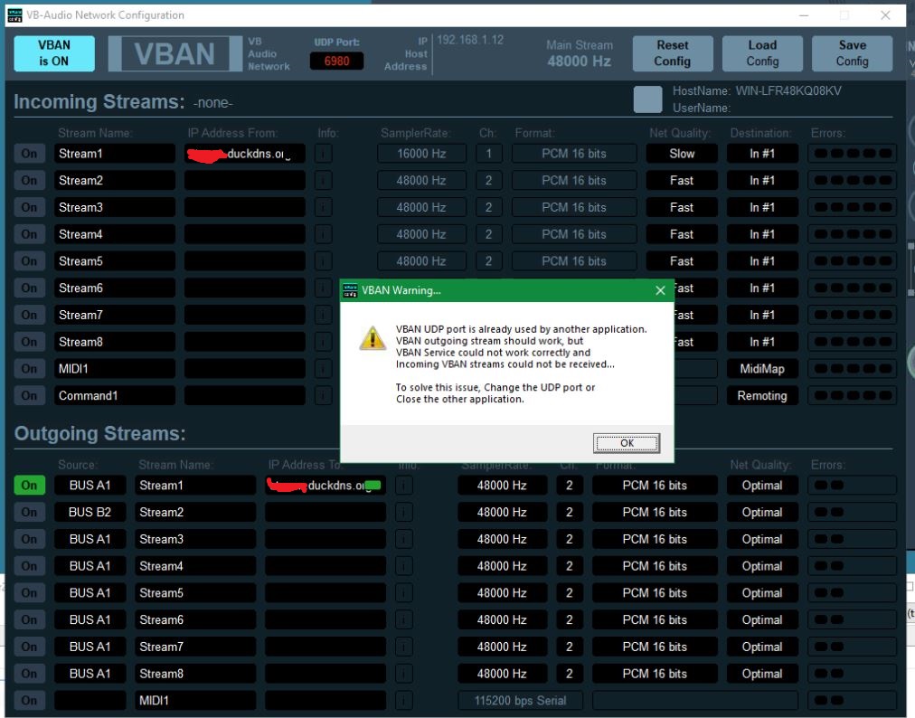

What does this error message mean? I need to stream bi-bidirectionally, i. e. from PC1 to PC2 one stream, and from PC2 to PC1 another stream. Should I set different ports on each PC? No other programs use this port. Is there a chance that two instances of Banana are running at the same time?
- Error Message on PC1
- PC 1 Port Error.JPG (209 KiB) Viewed 47491 times
