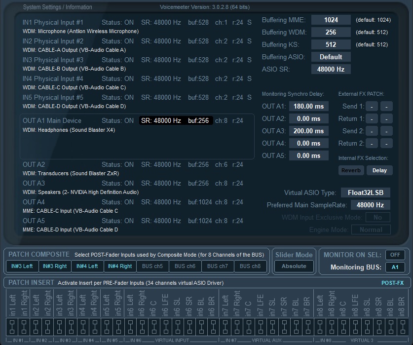

you may post a screenshot of your Voicemeeter system settings dialog box.
- Posts: 11
- Joined: Sat Jun 20, 2020 9:47 pm
Re: audio glitches and delay

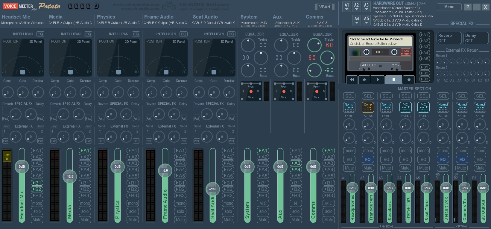

This is a basic setup that I use, though I sometimes use bus channels 5 and 6 in the patch composite, as well as A5 to route to Input 5, then A2.
- Settings.jpg (210.42 KiB) Viewed 12005 times
- Mixer.jpg (370.76 KiB) Viewed 12005 times

first remark: the usage of VB-CABLE C+D is not usual, since you create a loop between outputs and inputs (why?).
By using the SoundBlaster X4 device as output A1 , you define your Voicemeeter main stream in 48kHz with 256 samples buffer size.
This configuration is normally optimal and generate less than 10ms delay (2x buffer of 5ms).
but with your 180ms added in the Monitoring Synchro Delay , it makes around 200ms delay on output A1.
it seems you want to compensate the delay of the output A2 (Transducer) that seems to have an incredible delay out of Voicemeeter.
you may come on our Discord server to find someone with a similar configuration maybe...
