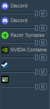

Hey there,
I was about to set up my "Stream Deck" with Voicemeeter Potato and tried to use the script feature "Strip.AppMute" but some programs e.g. Steam and some games like Call of Duty will not have a name in the app tab. Is there any workaround or possible fix?
Tried to run Potato as administrator, clean, reinstall and also tried the programs original names as they are called in taskmanager
Posts: 2171
Re: Potato script issue with Strip[i].AppMute
strange point, are you using latest Voicemeeter Potato Version ?
