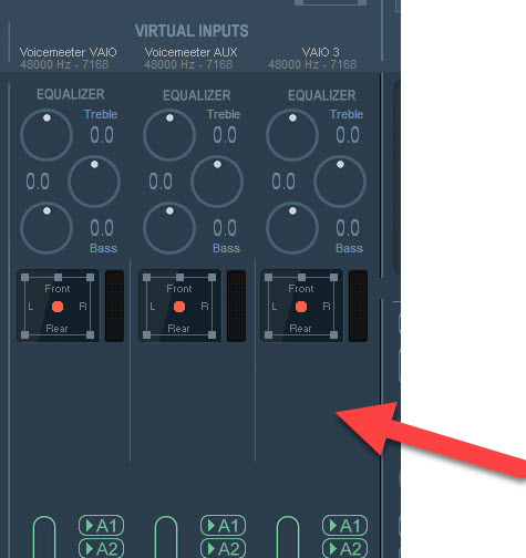

- Posts: 5
- Joined: Sat Jan 28, 2023 8:17 pm
Re: No longer run the sound through Voicemeeter on WIN 11 Prof
Thank you very much.
Yes, the virtual inputs were deactivated. I have activated them, but no sound comes in. For example, when I start a browser and run YOUTUBE, the programme is not assigned to a virtual input. So nothing comes out of the loudspeaker.
The microphone works, right. But otherwise, no sound source or programme (Spotify or browser).
It is strange that the "virtual output" appears under "input", as shown in the picture...
- 30-01-2023_18-50-03.jpg (30.04 KiB) Viewed 44281 times

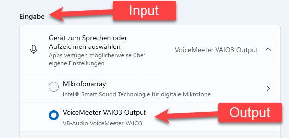

- Posts: 2162
it's logical:
the Voicemeeter output is a recording device = a microphone (a windows input) in order to be used by application to capture the audio stream (coming from the related Voicemeeter output BUS).

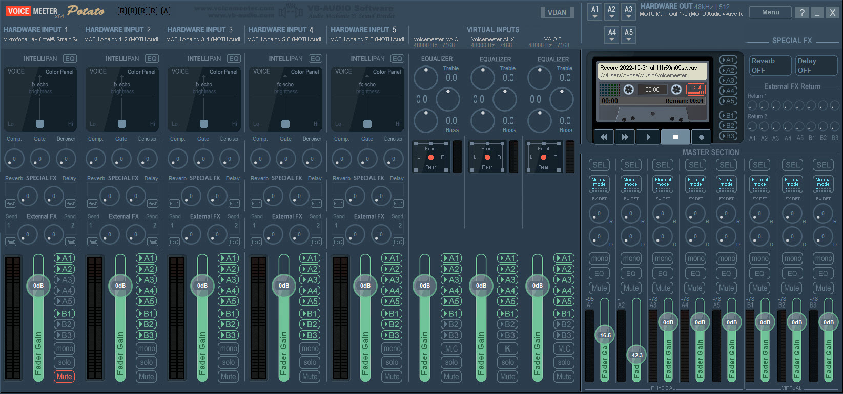

- Posts: 2162
You know it's very difficult to help without seeing your entire configuration,
so you may at least post entire Voicemeeter screenshot (if not the same than above in previous message) and also the screenshot of your Voicemeeter System settings dialog box (see in Voicemeeter menu).
but in your case , you may go in your Windows Sound device options to check that Voicemeeter input are present in Playback device list (Voicemeeter virtual input are windows audio output).

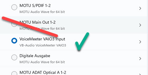

- Posts: 5
I have found the error!
I had selected the Main Out of the sound card as the output and not the Voicemeeter Input!
I changed the settings and now it works as desired.
Thanks for your patience.
