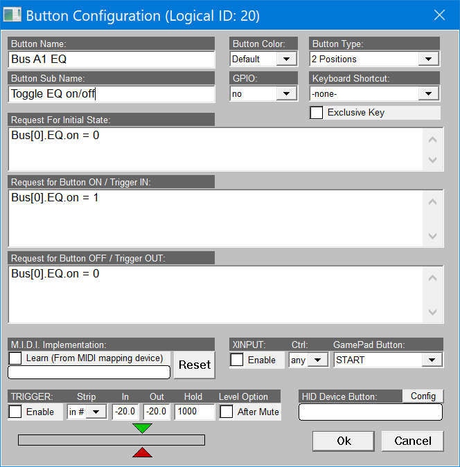

Is there a macro function that enables/disables the EQ in a given bus?
I failed to find it on the VoiceMeeter User Manual - using VM Banana here.
Thanks a lot!

The function is Bus[ i ].EQ.on
Set to 1 to enable EQ, 0 to disable.

Thanks a LOT, Ragnar!!!!
