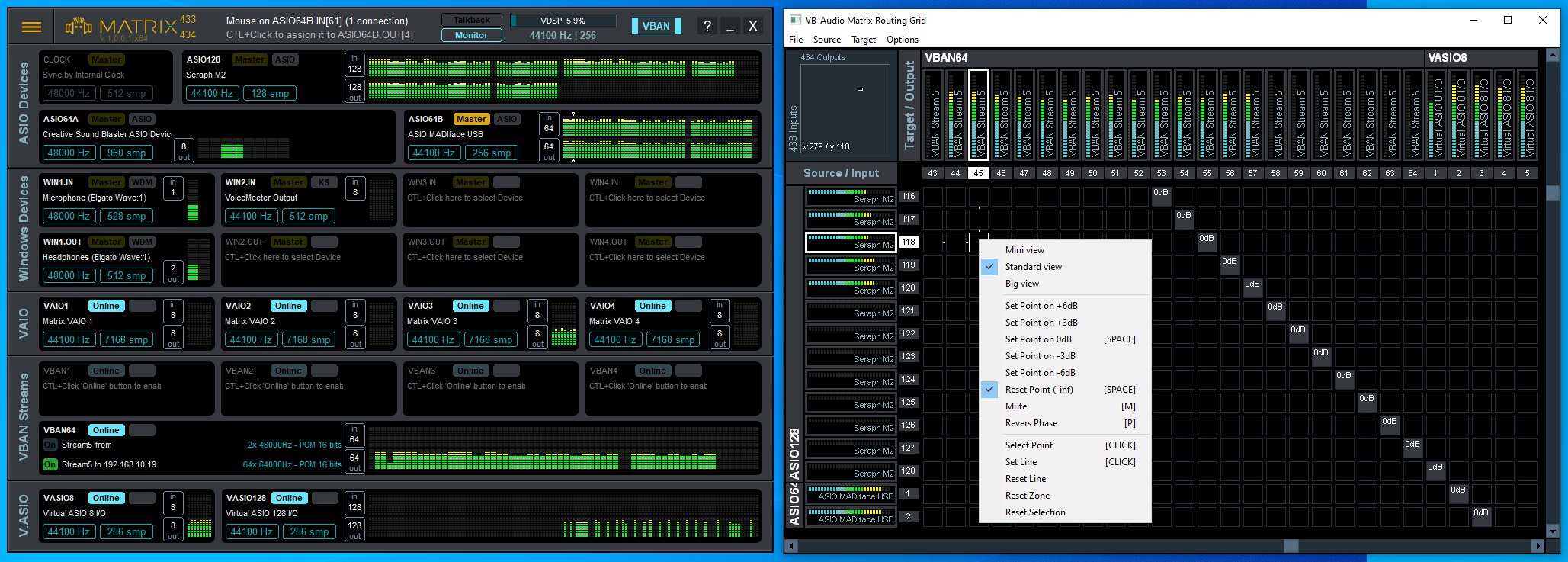

VBAudioMatrix is an Audio router Application for Windows to let you patch any input into any output. This is a specific tool to manage the routing of any audio points (physical or virtual). This is interesting for seasoned sound engineers, Expert Voicemeeter users willing to get more routing capabilities, and finally any users having several audio devices and applications to connect together channel by channel.

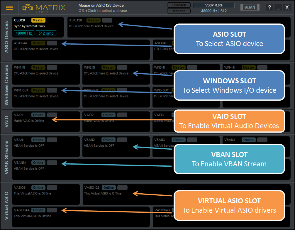

VB-Audio Matrix + Quick Guide
VBAudioMatrix is mainly self explained.
The Main View displays contextual help on caption when moving mouse on. Most of control can be used by "CTL+Click".
Right Click to get contextual menu and other shortcut.
Each Slot a specialized to manage the 5 different Audio Points.

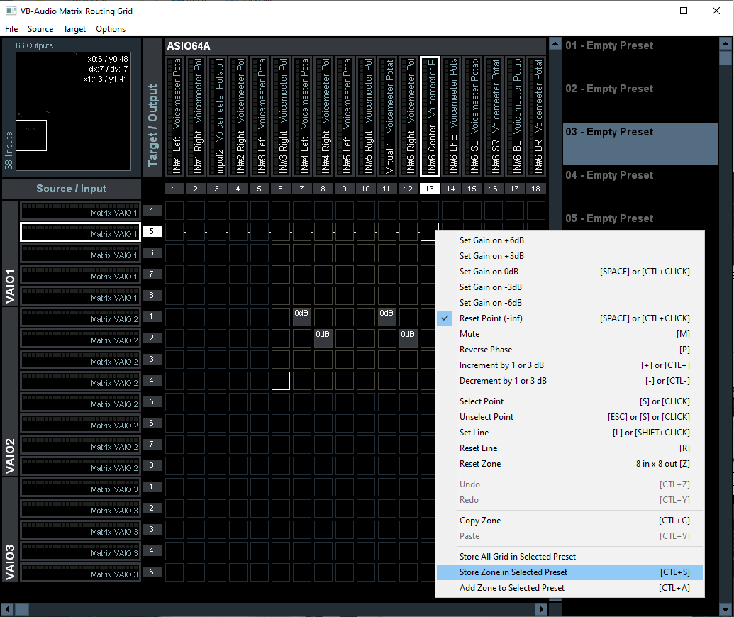

Matrix Window View supports different key combination with arrow to move on the grid:
  • CTL+arrow to move page by page.
  • SHIFT+ arrow to move slot by slot.
  • ALT + arrow to move point by points (activated points).
For example to Define Preset Patch:
  • 1- Select the preset you want to define.
  • 2- Define a Zone in Matrix,
  • 3- Right Click and select "Store Zone in Selected Preset".
  • 4- you can also add a Zone and build Preset with up to 64x zones.
Then you can use your PRESET path in different way (right click on PRESET to get contextual menu).
REM: The preset is automatically stored.
