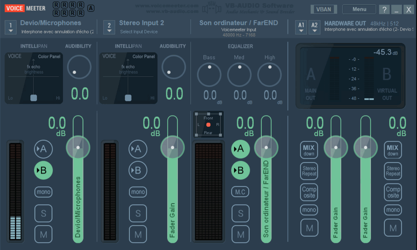

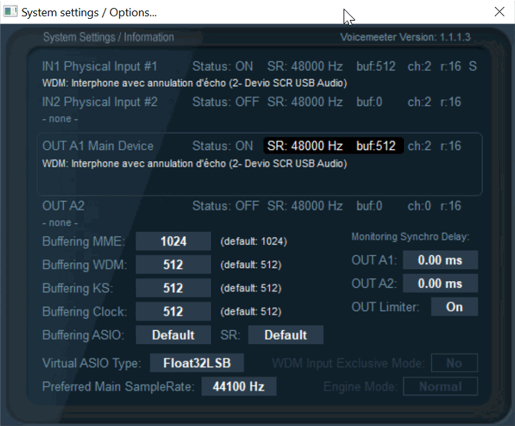

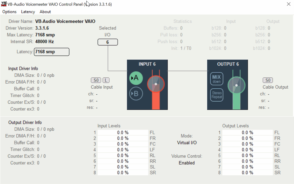

- Posts: 2184
Re: Voice Meeter - Strobe effect on sound
You may post screenshot of Voicemeeter and its system settings dialog box to let me see your current configuration.
- Posts: 9
- Joined: Wed Jun 28, 2023 2:50 pm
As requested,
Screencapture of the settings.
Thank you for your help
- Capture_VoiceMeeter_VAIO_Settings.png (71.21 KiB) Viewed 23634 times
- Capture_VoiceMeeter_Mixer_Settings.png (125.82 KiB) Viewed 23634 times
- Capture_VoiceMeeter_System_Settings.png (63.29 KiB) Viewed 23634 times
