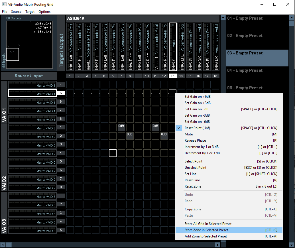

I know that the documentation probably needs to catch up. I see a Preset list over to the right with a bunch of empty presets. I'm not sure how to apply and manage patches. Can someone summarize?

To Define Preset Patch is very simple:
1- Select the preset you want to define.
2- Define a Zone in Matrix,
3- Right Click and select "Store Zone in Selected Preset".
4- you can also add a Zone and build Preset with up to 64x zones.
Then you can use your PRESET Patch in different way (right click on PRESET to get contextual menu).
REM: The preset is automatically stored.
