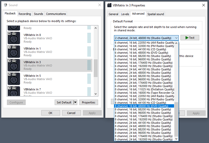

With all of that said, unfortunately, I still will not be gaming with Matrix, because it doesn't support bitstream passthrough of Dolby Atmos to an AVR. I renamed Matrix' input #3 to "7.1 speakers (VBMatrix In 3)" (or something like that) and in Matrix, I mapped that input to my AVR, which is connected via HDMI. In Windows, with my AVR being the primary audio output device, I enabled Dolby Atmos for Home Theater. Then I switched the audio output device to Matrix's VAIO 3 input. The message that the Dolby Access app gave me when I tried to configure Dolby Atmos for Home Theater on the VAIO 3 input is shown in the attached screenshot.

VAIO #3 being a "Line Out" device, you have to set it's default format to 8channel to let it support 7.1 audio stream (PCM only).

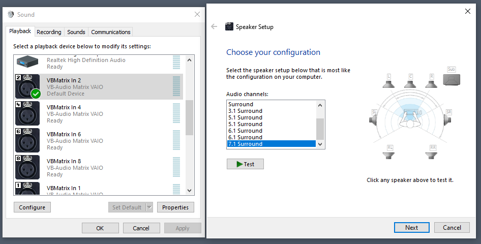

VAIO #2 being a "Speakers", you have to use the configure button to activate the 7.1 audio stream (PCM only).

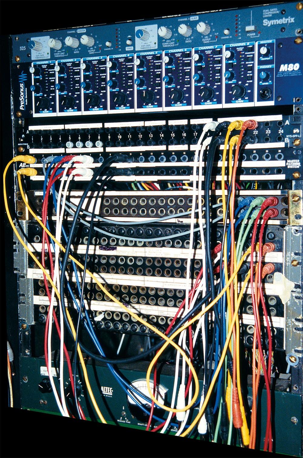

What is a real-life equivalent of the Matrix for audio? Would you be so kind and attach a picture of such a thing and add just a few words on where one might see such gear being used? I checked the translator (in my language: audio krosownica), but it is not the same device.

A real life equivalent could be a patch panel.

OK, great. But it seems the patch panel lacks what the Matrix offers here, i.e. setting up levels per matrix element, or any group of elements. There is no real-life equivalent to this, right? Well, a mixer is (to some extent), but the Matrix isn't exactly like a mixer.
Posts: 2206
Re: Matrix functionality (Voicemeeter replacement? No Dolby Atmos for Home Theater)
there is such audio matrix in some broadcast audio infra structure, and mainly in Audio Po Mixing Console usually offering an audio matrix to manage different channels, network, interfaces, internal or external BUS, FX, etc...
Generally speaking, a mixing console is basically built on a Matrix architecture.
