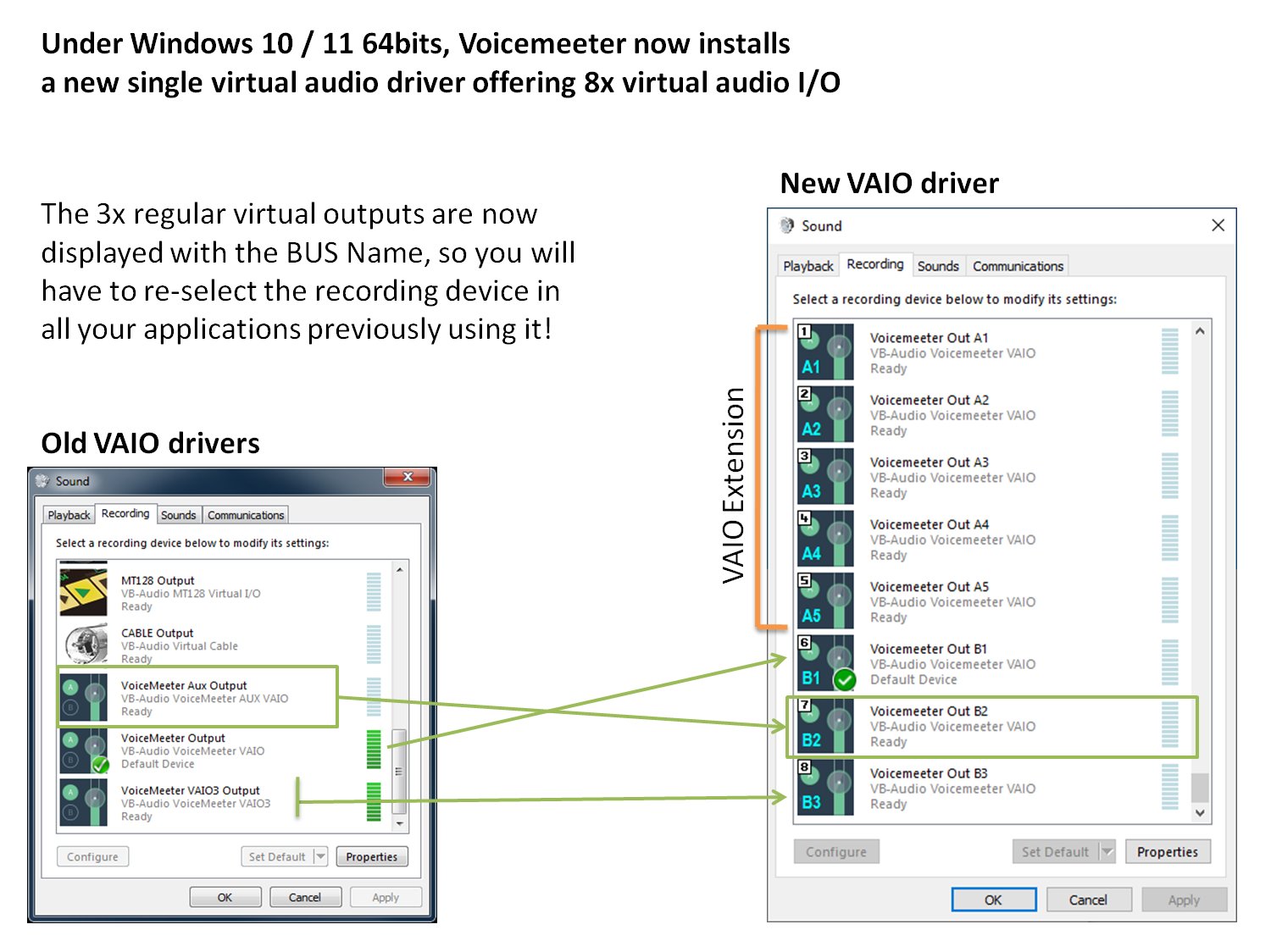

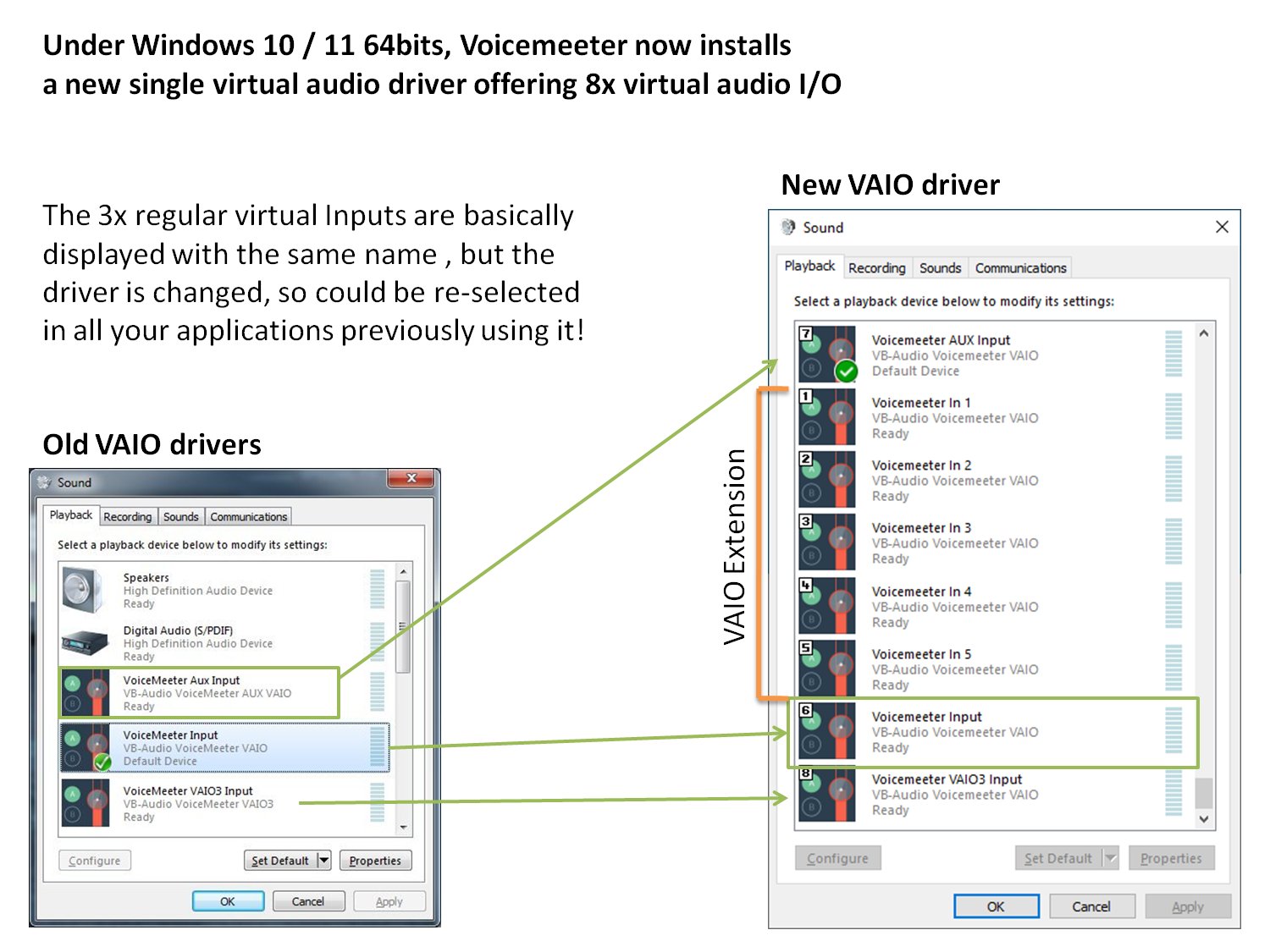

The New Voicemeeter installs a new virtual audio driver offering 8x I/O (under Windows 10/11 64bits) so you may think about checking / re-defining device selection in all applications previously connected to it.
- "Voicemeeter output" is now called "Voicemeeter Out B1"
- "Voicemeeter AUX output" is now called "Voicemeeter Out B2"
- "Voicemeeter VAIO3 output" is now called "Voicemeeter Out B3"
Virtual inputs have basically the same name, but the driver is changed, so could be also re-selected as playback device in your different applications using it.

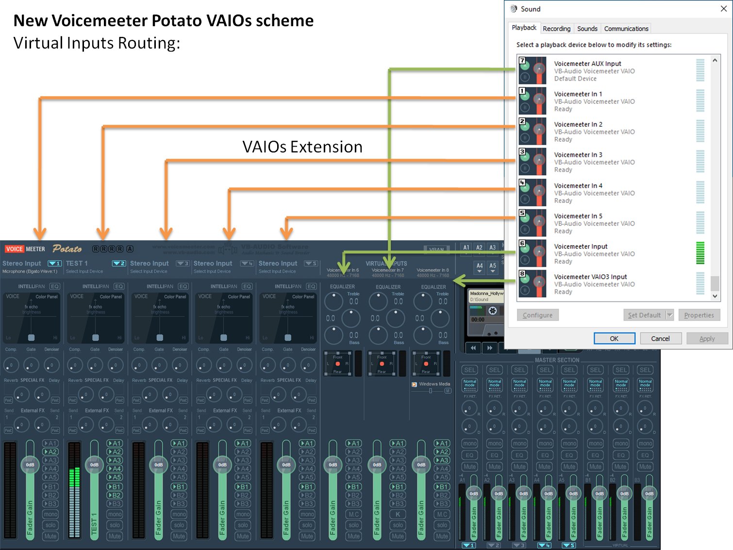

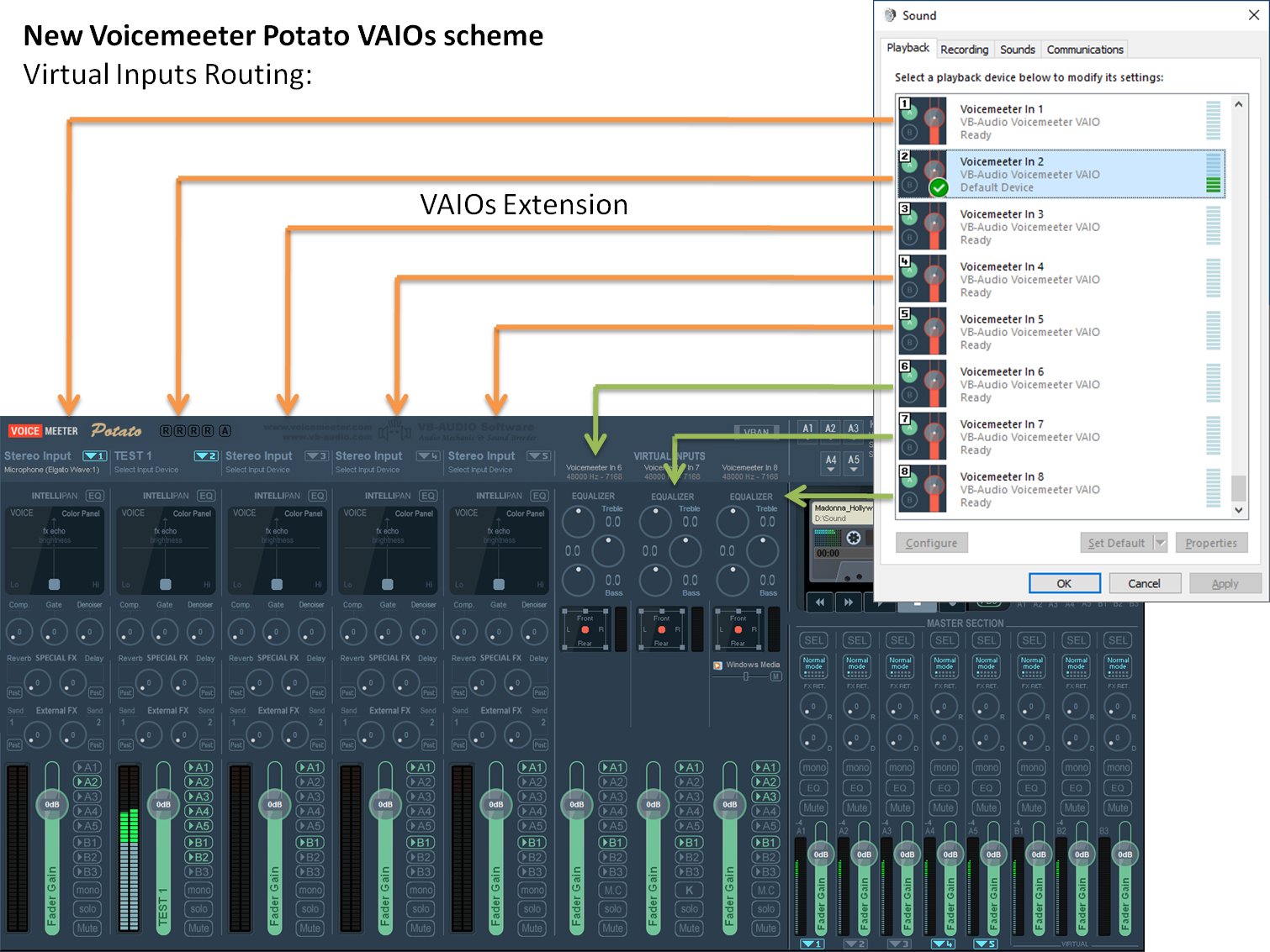

then VAIO 1-5 could be connected to Voicemeeter Hardware Input and from Physical Output Bus (just by a simple new button).
here below the default naming for virtual input after Voicemeeter installation:

the "Reset Pin Name and Icon 2" item will rename Voicemeeter virtual input into "Voicemeeter in #1 to #8" while
the "Reset Pin Name and Icon 1" item will rename Voicemeeter virtual input 6,7,8 to historical name (set by default)
"Voicemeeter in 6" = "Voicemeeter Input"
"Voicemeeter in 7" = "Voicemeeter AUX Input"
"Voicemeeter in 8" = "Voicemeeter VAIO3 Input"
