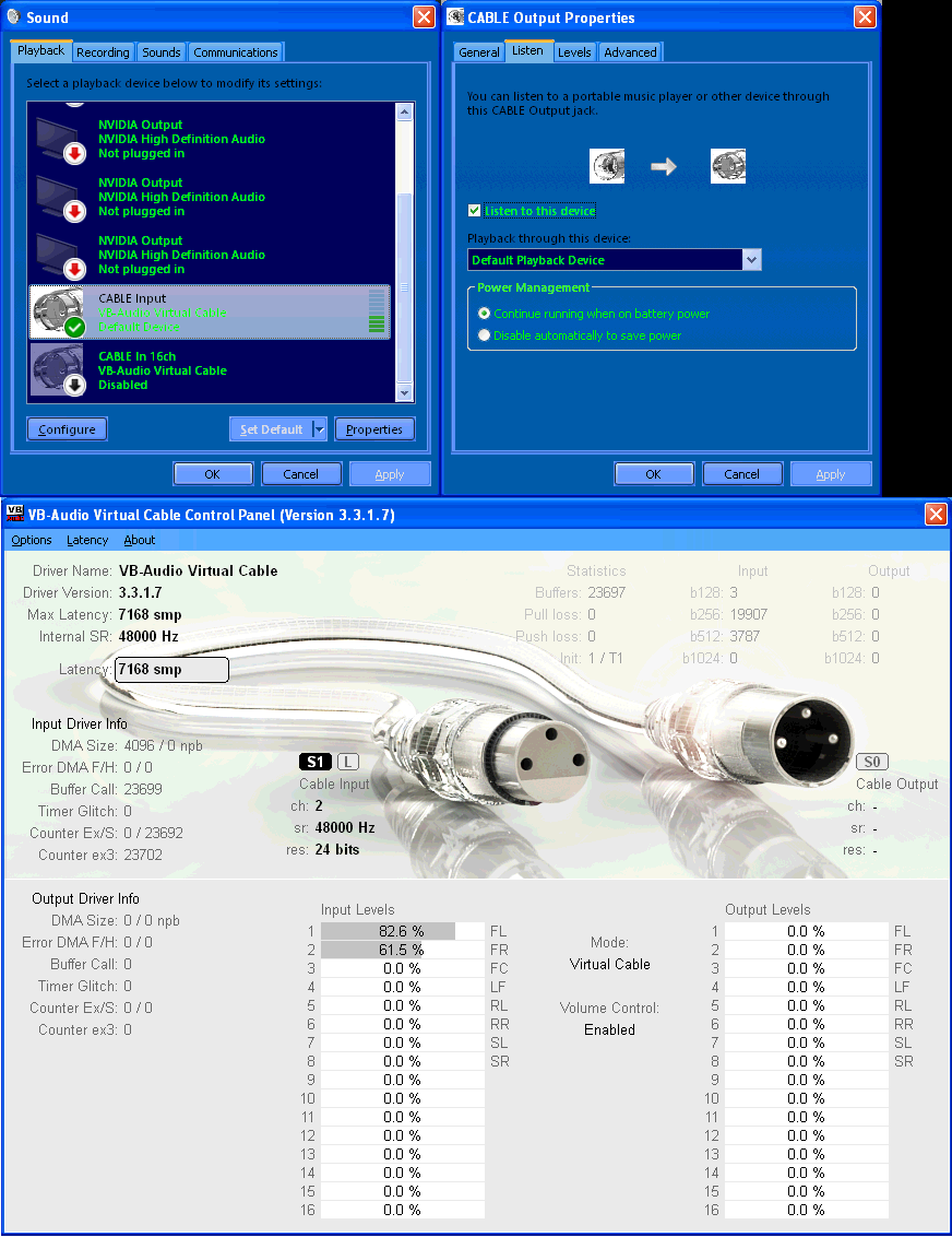

Re: Can't hear anything after installing on Win10
Certainly!Vincent Burel wrote: Wed Aug 20, 2025 7:28 pm could you post screenshot of your VBCABLE control panel for example ?
- VB screenshots.png (139.39 KiB) Viewed 184507 times
- Posts: 2225
seems to be normal, but you have nothing connected to the VB-CABLE output and your listen option makes no sens.
if you want to listen the recording device (VB-CABLE output), you must route it to a physical device (not to VB-CABLE input again, since it is your default playback device).

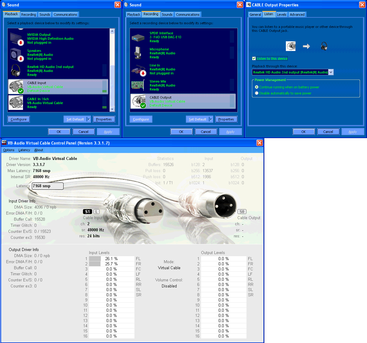

- Posts: 2225
change your listen option to route the VBACALE output to your physical speaker or headphone.
post a screenshot of the CABLE output properties dialog box, to let me see.
Tried that.
Interestingly, after updating my drivers I now see Stereo Mix as a recording device, but tragically it doesn't work. This is why your program is so important.
