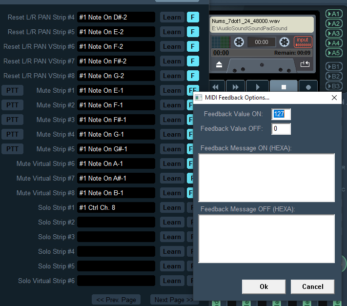

did you try the custom feedback ? right click on 'F'.
Snapper
- Posts: 10
- Joined: Thu Nov 25, 2021 6:36 pm
Re: MIDI out with VM + MacroButtons on the same device not working
I have seen this in documentation, but don't know really how to use the feedback message fields or what their purpose is for. The manual states it for "complex midi feedback" - but not how to use it nor some examples, just that it exists and I find it a bit non-intuitive...
e.g. Feedback Value ON/OFF is written/stated in decimal, but then following Feedback Message seems to requiere a RAW HEX string - where do I get this string from/how do I "build it"?
I have seen those when when I monitor a devices messages with the software "MIDI Tools", but I can't get it to monitor the output from MacroButtons, no matter what I try (closed all midi apps, only MacroButtons and MIDI Tools alive - nothing).
For test purpose I have written the following codes from MacroButtons in the "feedback Message ON/OFF (HEXA)" fields of a unused entry in the custom feedback dialogue, which after close/reopen is then "translated" to the following line:
Seems like ctrl "49" remains still in decimal (tried other values - they remain 1:1) - which is very suspicious, whereas all other code is somehow translated into HEX. I can't figure out how the translation to MIDI RAW HEX is done, all documentation I find online is basically only about converting hex<>dec or about MIDI CC standard messages, which doesn't help at all.
(And for clearence - nothing happens - [System.SendMidi("out1", "ctrl-change", 1, 49, 127);] should light on the LED on ch1/ctrl49 button as it does proper with MacroButtons - even if I change decimal ctrl "49" to hex "31")
But even if it would work somehow, for my initial need (switch BUS A1 output Mode between normal and 7.1 upmix) this wouldn't be a solution, because there is no entry for switching BUS output mode in the VM MIDI Mapping dialogue... (thats why I use MacroButtons for this purpose atm - but with lack of MIDI feedback)
-> "EE DD 1C CA E1 49 12 "feedback message ON (HEXA) wrote:System.SendMidi("out1", "ctrl-change", 1, 49, 127);
-> "EE DD 1C CA E1 49 "feedback Message OFF (HEXA) wrote:System.SendMidi("out1", "ctrl-change", 1, 49, 0);
Late reply, but nonetheless...
You are supposed to enter the raw bytes of the MIDI message, in hexadecimal.
See here for the structure of MIDI messages: https://www.songstuff.com/recording/art ... ge-format/
Your control change, channel 1, controller 49, value 127 would be
Ragnar
B0 31 7FRagnar
