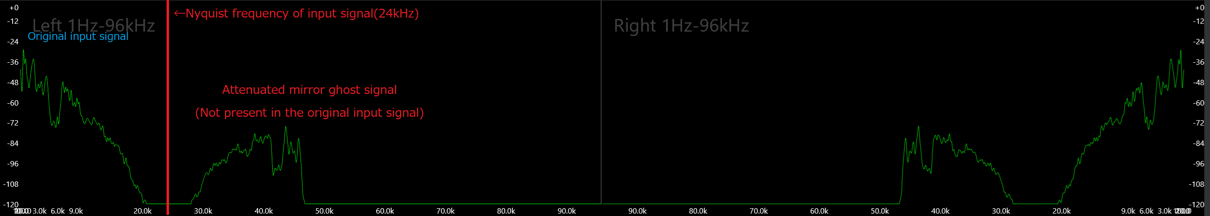

Re: How to prevent noise that exceeds Nyquist frequency of input signal when upsampling
For example, upsampling a 48kHz signal to 96kHz will result in ghosting, as seen in the attached image.
- upsampling_noise2.png (76.74 KiB) Viewed 73147 times
- Posts: 2214
As i replied in some other thread, difficult to reply without knowing perfectly your experimental protocol.
our SRC can generate some noise around 60dB or 70dB below the nominal level (which is normally not hearable).

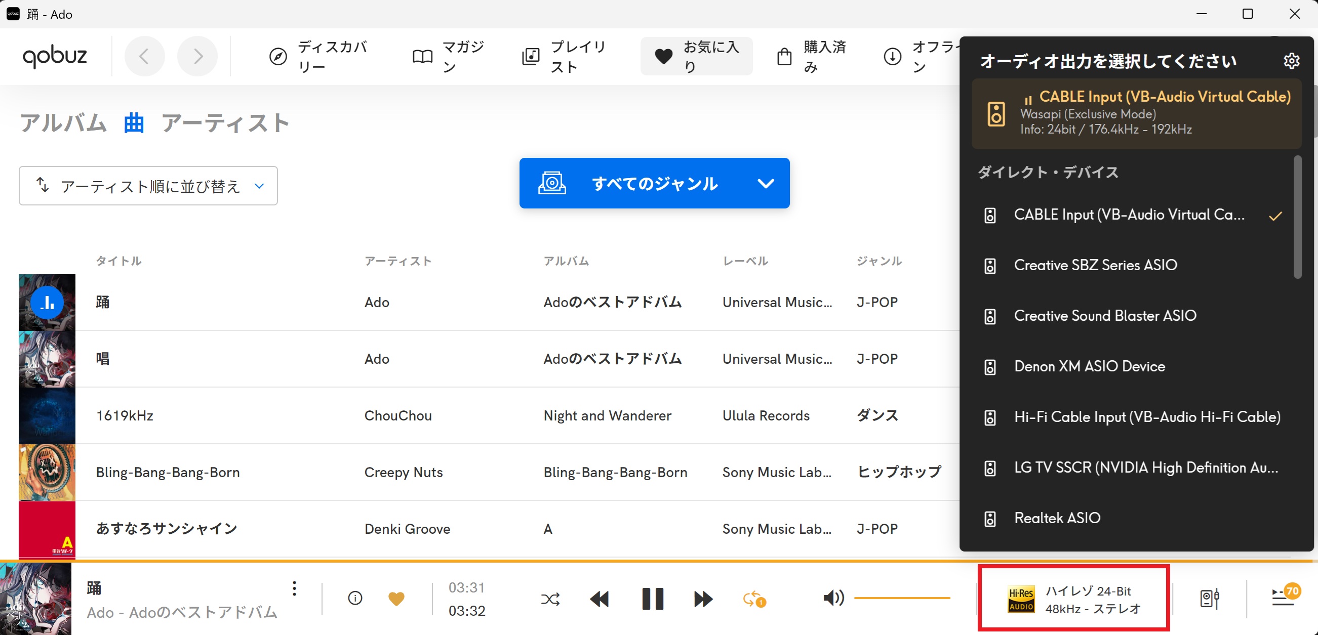

VB-CABLE input:
Music streaming service "Qobuz" application
- The application dynamically changes the sample rate to match the audio file.
- WASAPI exclusive mode
- qobuz.jpg (400.74 KiB) Viewed 72970 times

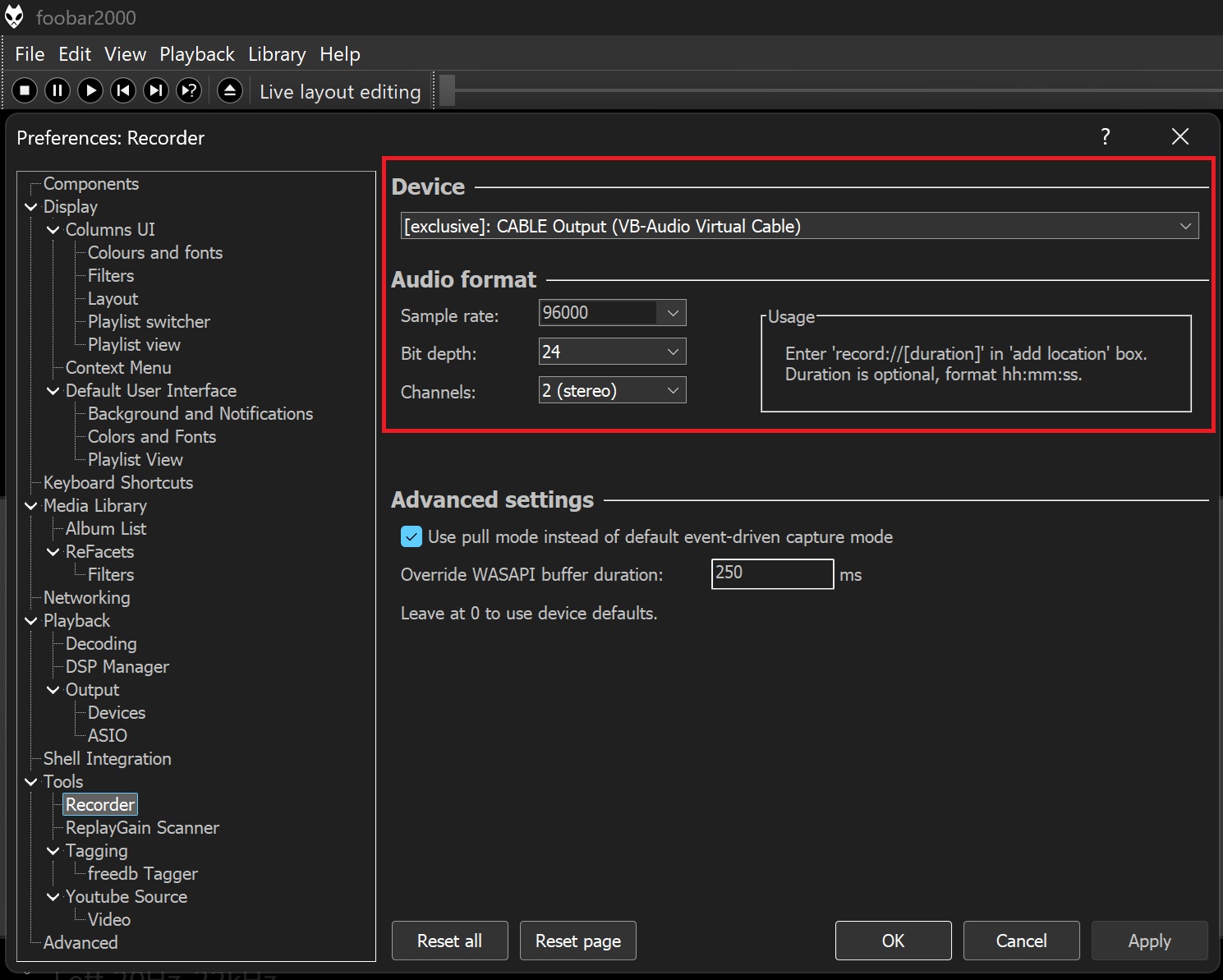

VB-CABLE output:
foobar2000
- Recorder plug-in input
- Fixed at 96kHz/24bit
foobar2000
- foobar2000.jpg (270.8 KiB) Viewed 72970 times

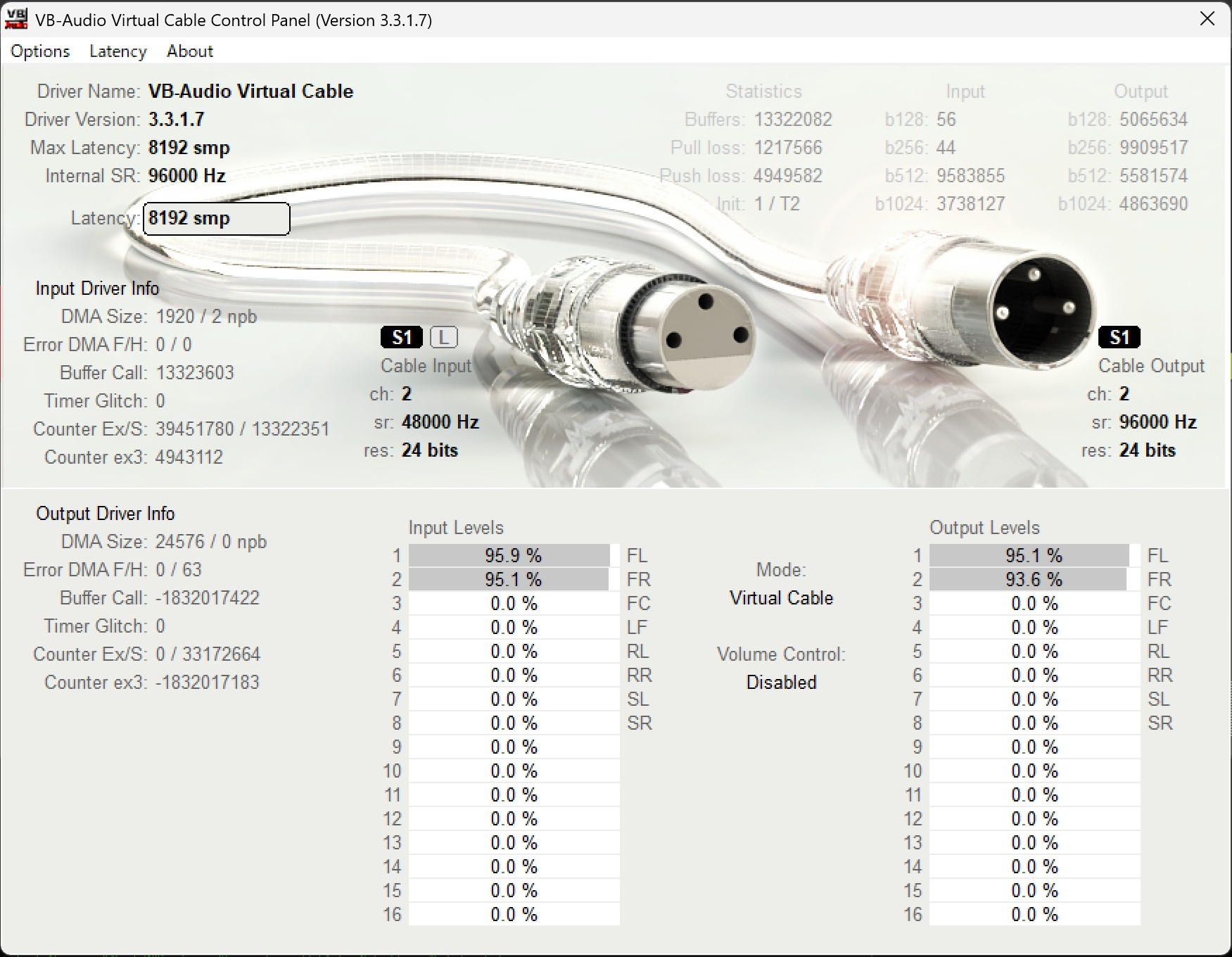

VB-CABLE control panel in play:
- VBCABLE_ControlPanel.jpg (491.27 KiB) Viewed 72970 times

- Posts: 2214
ok, thanks for bringing some screenshot.
1- My first reply was about the fact i did not see any reason to get noise above -70 dB , if present, it means there is another problem in the audio chain.
2- I don't know foobar, i recommend to use our Spectralissime instead: https://vb-audio.com/Spectralissime/index.htm (but it's 20-20KHz only right - i need to update this tool).
3- There is a strange Error DMA F/H 0/63 on VB-CABLE output (Control Panel) meaning a serious audio stack problem or bad way to capture audio from the VB-Cable recording device.

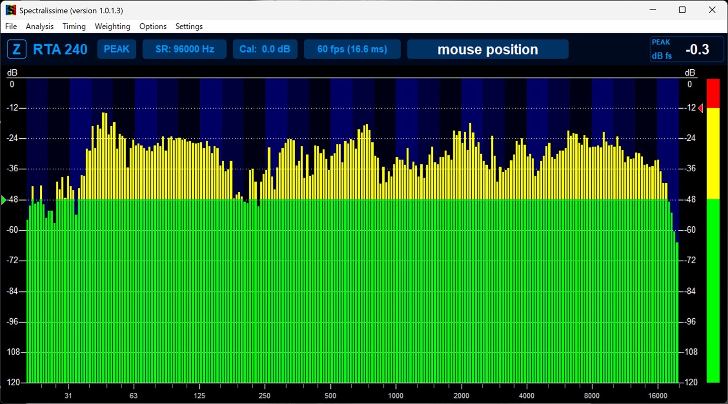

Reffi
- Posts: 9
- Joined: Thu Jun 05, 2025 3:11 am
I tried installing Spectralissime.
(As you say, the problem occurs above 20kHz, so it seems unsuitable for verifying this topic.)
- Spectralissime.jpg (368.16 KiB) Viewed 71743 times
