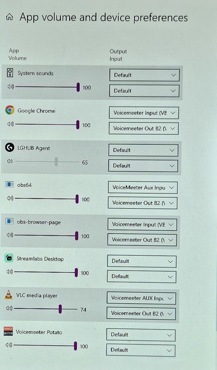

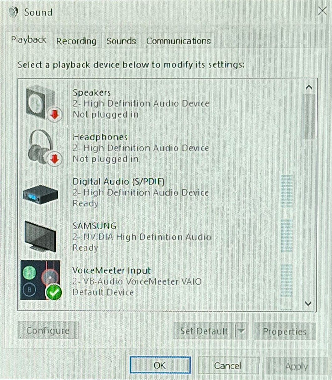

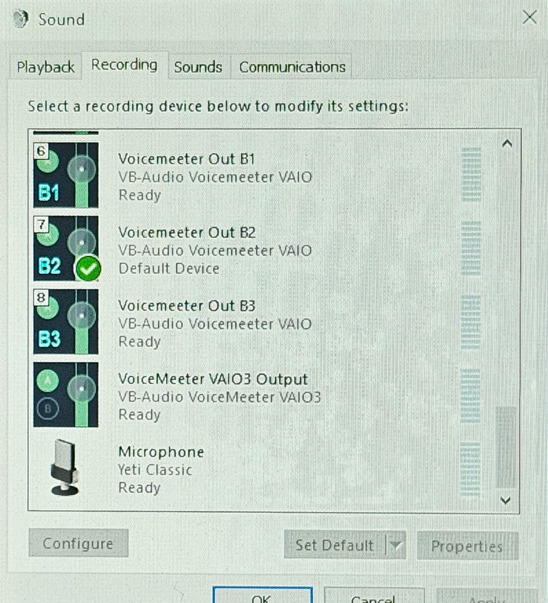

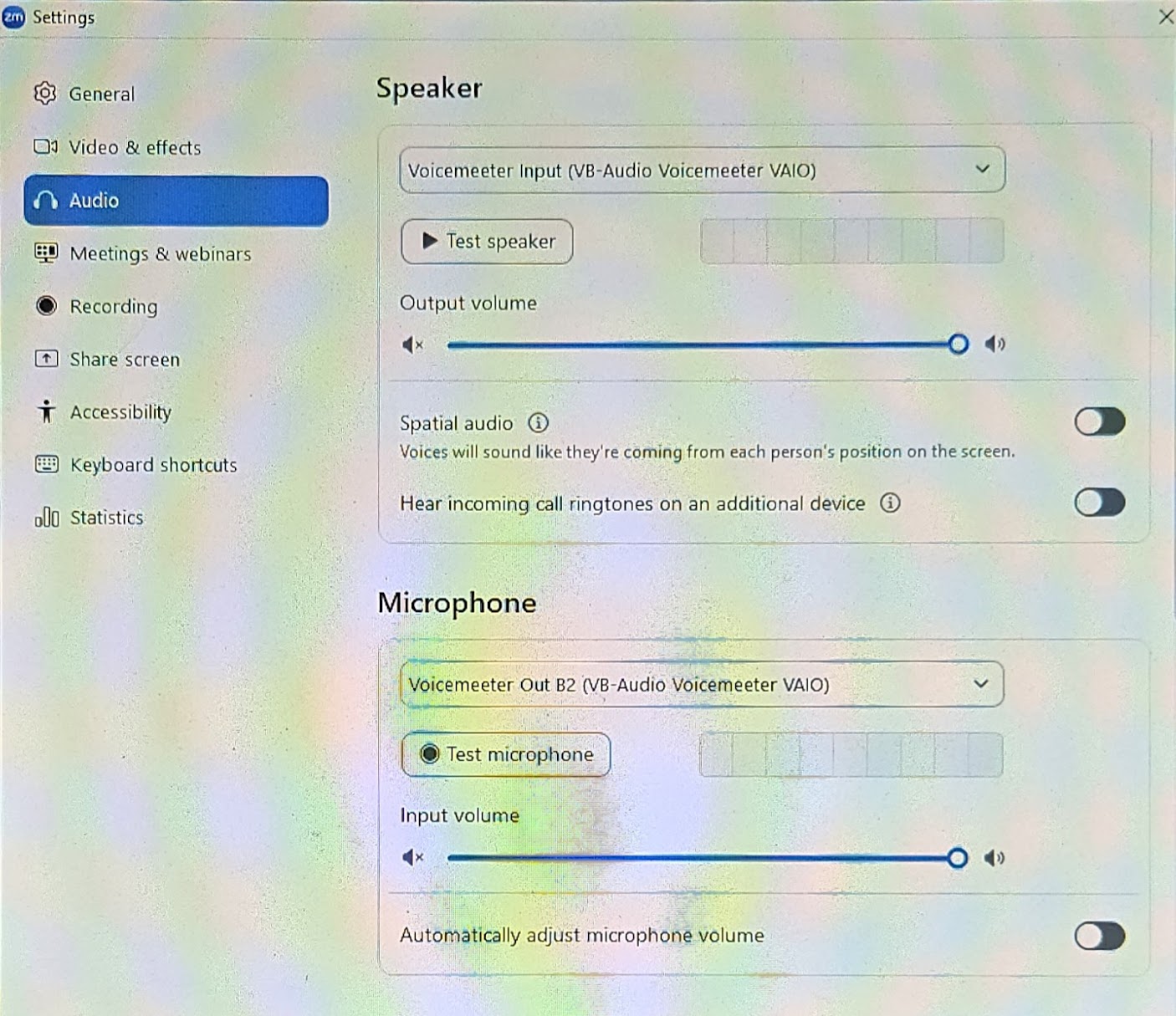

Technical Issue:
For the past 2-3 weeks, when playing music from VLC Player, Windows Media Player, or YouTube, the song lyrics go to Zoom, but the music does not go thru.
Current Setup:
Two mics (Wave Link and Yeti), Chrome (YouTube), and VLC Player, all routed to Zoom
It appears that I can not add additional photos in this reply. I will send more in another reply.

Re: Zoom receives lyrics but not the music
This shows VLC Player in the AUX I strip sending music thru B2 to Zoom.

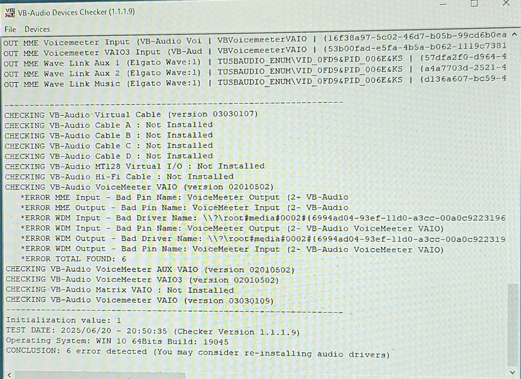

- Posts: 2191
REM1: it seems you have an installation problem, because you have old Voicemeeter VAIO driver installed and new one... this can produce unexpected behavior i guess. So you may uninstall Voicemeeter and check there is no more voicemeeter audio driver presence in Windows Device manager.
read this topic: viewtopic.php?t=381
then install latest Voicemeeter version 3.1.1.9 and don't forget to reboot your computer after each step.
I uninstalled VMP per your instructions (and the instructions of the link viewtopic.php?t=381) and re-installed version 3.1.1.9 from VB-Audio:
It appears that the driver versions are all the same as previous install, as it came from your website:
VM VAIO driver:
VM VAIO driver:

After the reinstall, the technical issue is still there. Everything works except the music is not streaming through to Zoom.
I see that the VB-Audio Matrix VAIO driver is not installed. Do I need this?
Also, did you notice if the settings for Voicemeeter, Windows apps and Zoom are all correct?
