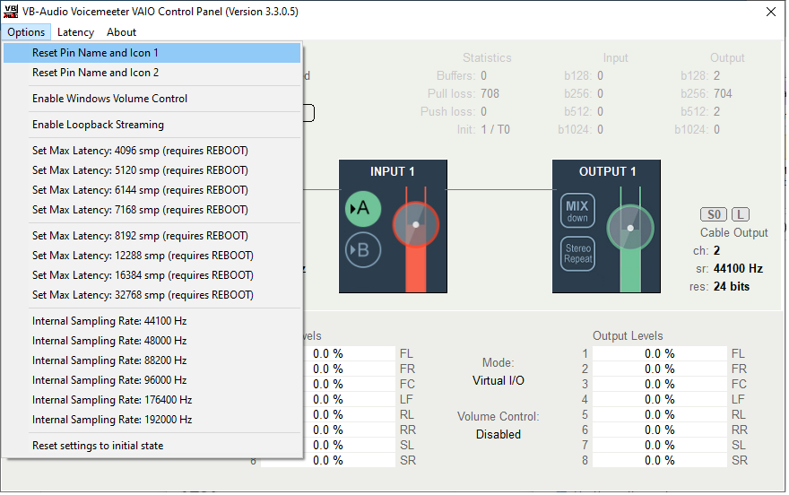

I dont know what to do I have used both regens and still dont have a working system, voicemeter must be mucking up windows as it's ok until I install voicemeter, I also am not sure what drivers and were to find them to reinstall as report suggests. Chris, I should say exasperated Chris

according your driver checker log, Voicemeeter VAIO are not well installed. possibly because you did not reboot after installation.
if Voicemeeter VAIO have not the right name (and icon) these cannot be used by applications.
To fixe your problem, run VBVoicemeeterVAIO_ControlPanel.exe in administrator mode
(you will find it in C:\Program Files (x86)\VB\Voicemeeter folder).
then go in menu to select "Reset Pin Name and Icon 1"
Some VB-CABLE seems to be not well installed too... thanks to post your Windows Device Manager screenshot (section "Audio, video and game controller").
If you cannot fix your problem, you may consider uninstall Voicemeeter and VB-CABLES, and reinstall them correctly (by rebooting your computer on each step - ). more info: viewtopic.php?f=7&t=688

That didn't alter anything!
The saga continues, re-purchased virtual cable A & B (yes I did restart), same problems with Rundll32, uninstalled restarted re installed restarted. When I click on .exe a window comes up “missing ‘inf’ file or driver corrupted. . .

I can confirm they have been uninstalled restarted reinstalled restarted several times all with the same results!! Surely I cant be the only user having these issues with windows 11 25H2?
Re: windows 11 - voicemeter crashing
Posted: Tue Dec 30, 2025 11:40 am
if you have redefined Pin name of your VB-CABLE A+B, you must ignore this error. this should be considered as warning instead (i will check the DriverChecker program).
