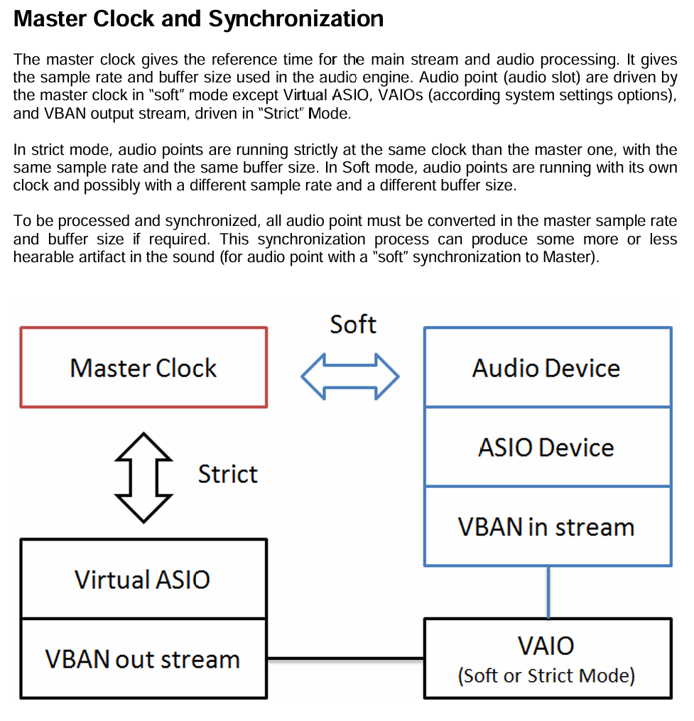

yes, you can get some more or less hearable artefact on soft synchronized devices (device running on their own clock) with different QOS : one per minute, one per hour... pending on clock differences and also pending on the latency buffer size in use (the first way to minimize them is to increase the buffer size and use the SECURE "latency performance mode").
For most of users it works pretty good because using device with same chipset or same clock speed... There is more problem when using old devices, built with different generation of chipset/clock from different manufacturers...
We are still working on minimizing it or make them not hearable, but the only true solution to avoid this problem, as you may know, is to link all devices with a common WordClock (only present on professional devices).
Everything is explained in the documentation page 26: https://vb-audio.com/Matrix/VBMatrix_UserManual.pdf
