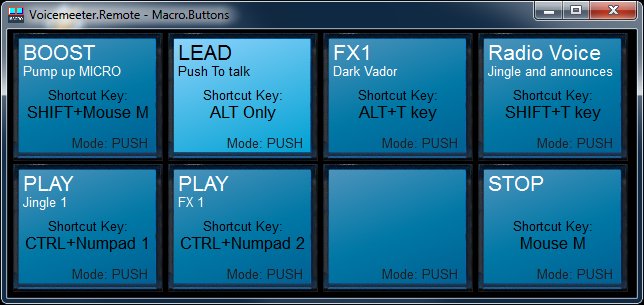

With the latest Voicemeeter Pakage 2.0.2.3 , MACRO Buttons application is now installed with Voicemeeter
and can be used to control Voicemeeter by buttons, for example to make PUSH TO TALK functions, or FX or even make a Sound Board.
Each button is programmable by using Voicemeeter Remote Requests (right click on the button to get the dialog box below)
it provides basically 3 possible script:
- Initial : to possibly fixe the initial control state (when the application is launched - Voicemeeter or MacroButtons).
- ON: the request(s) sent when pushing the button
- OFF: the request(s) sent when releasing the button
A keyboard key or mouse button can be associated to one or several button (possibly exclusively).

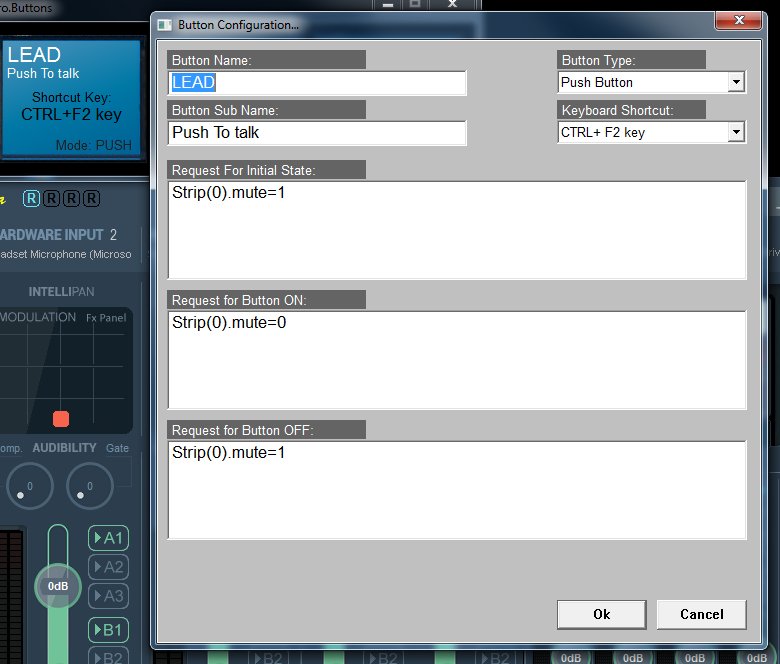

Macro Buttons Application / PUSH TO TALK
With MacroButton Application it's now easy to make one or several PUSH TO TALK buttons
As Initial state, we want to set the strip as muted (mute=1).
when we push the button, we unmute by sending the appropriate request (mute=0) and we mute again on button release.
It is also possible to manage other strip by adding some requests, for example to set the music strip to -10db when talking and reset it to zero dB on button OFF...
Macro Button offers many possibilities to remote Voicemeeter...

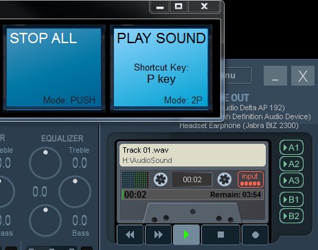

Macro Buttons To Launch Sounds
With the recorder's requests it is possible to use the Macro Button Application as Sound Board to remote the Banana Player to launch sounds (one sound at a time).
For example, this request below will ask to Voicemeeter Banana to playback
the Track 01.wav sound located in the H:\AudioSound directory.
recorder.load="H:\AudioSound\Track 01.wav";
If the option Play on Load is not set, you will have to add a request to play it
recorder.Play=1;
To Stop the Banana Player:
recorder.stop=1;
With Voicemeeter Version 2.0.2.3, it is also possible to set the gain (in dB) of the playback:
recorder.Gain=-10.0;
recorder.Play=1;
recorder.stop=1;

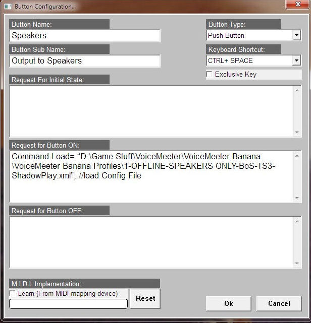

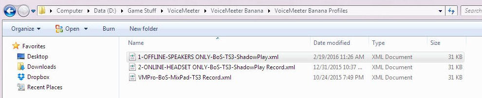

I cannot get the Macro Buttons Application to load my profiles. When I click the button or use the hotkey, the button flashes but the profile is not loaded into VoiceMeeter. It's possible that I have misinterpreted the use of Macro Buttons or I've configured incorrectly. Can you tell what I need to change or can it be done? Below is a picture of one of the Button Configurations. Thanks

Re: Macro Buttons Application
ha, the problem comes from the comment at the end of your line : remove "//load config file".
this will be accepted in next version of Macro Buttons.
Thanks for the reply. Just for clarification. I removed "//load config file" from the end of the line. The line now reads Command.Load= “D:\Game Stuff\VoiceMeeter\VoiceMeeter Banana\VoiceMeeter Banana Profiles\1-OFFLINE-SPEAKERS ONLY-BoS-TS3-ShadowPlay.xml”; but still does not work. Did you mean that the "Command Load" request string will not work until the next update?Vincent Burel wrote:ha, the problem comes from the comment at the end of your line : remove "//load config file".
- Posts: 2225
no, it should work, check that the file name and path is correct...LoneStar wrote: Thanks for the reply. Just for clarification. I removed "//load config file" from the end of the line. The line now reads Command.Load= “D:\Game Stuff\VoiceMeeter\VoiceMeeter Banana\VoiceMeeter Banana Profiles\1-OFFLINE-SPEAKERS ONLY-BoS-TS3-ShadowPlay.xml”; but still does not work. Did you mean that the "Command Load" request string will not work until the next update?
otherwise you can try the last MacroButton just posted today on last thread...
LoneStar
- Posts: 9
- Joined: Wed Feb 24, 2016 4:55 am
Path is correct. Downloaded and installed v1007 buttons and it now works
. Thanks for the help. GREAT APPLICATION. A bit of a learning curve to setup. I do not use the full potential of this application but it gets the job done for me.
