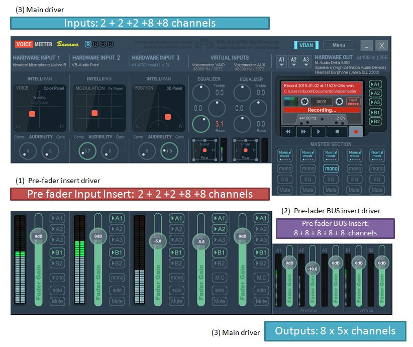

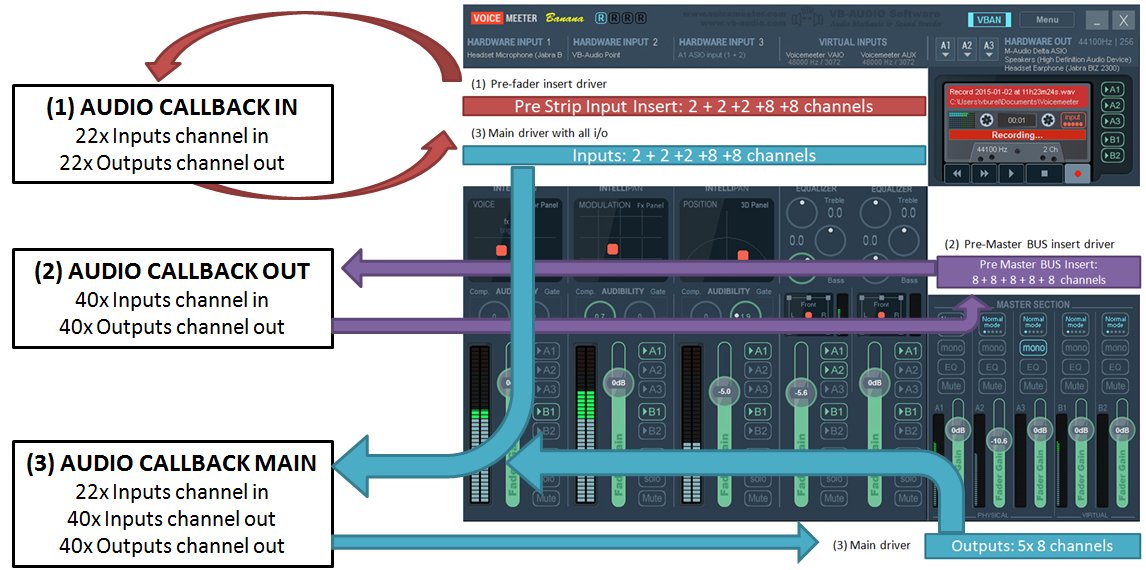

We are currently testing our Audio Callback Model to propose 3 different audio points inside Voicemeeter. Client Application will be able to basically register a callback for 3 different streams (possibly 3 in the same callback as well as one callback in 3 different applications):
(1)Input Insert Stream will allow processing audio on the Voicemeeter input stage before being processed by strip (color panel, EQ, comp, gate and fader).
(2)Output Insert Stream will allow processing audio on the Voicemeeter BUS output stage before master section (before mode, mono, master EQ and fader).
(3)Main Stream provides all inputs (after input insert) and all outputs (after fader, so after output insert) to process all I/O and possibly modify or replace all Voicemeeter BUS outputs.
VB-AUDIO CALLBACK API will be provided by Voicemeeter remote API (in same DLL). It will provide only 4x functions:
VBVMR_AudioCallbackRegister()
VBVMR_AudioCallbackStart()
VBVMR_AudioCallbackStop()
VBVMR_AudioCallbackUnregister()
The main advantage to use VB-Audio Callback mechanism is to receive and process all synchronized channels in same time, whatever the audio devices managed behind by Voicemeeter. VB-AUDIO Callback will be driven by Voicemeeter Main Stream and will support low latency (from 128 samples to 2048 samples).
