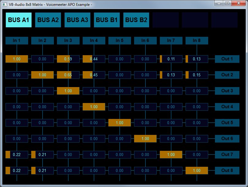

With Voicemeeter Audio API, it is now possible to make APO's (Audio Processing Object) working as application.
The first example provided in the SDK is a 8x8 gain matrix applicable to a selected BUS.
The application registers his own audio callback as OUTPUT INSERT on Voicemeeter to get all audio output channels before going to master section (all 'C' source code available in SDK package).
The executable application can be found in the VoicemeeterRemote SDK package (see general information topic).

I have trouble understanding the use of this tool.
Is it possible to have a video of use?
Best regards
Posts: 2214
Re: Gain Matrix 8x8 (APO As Application)
Well, it's expected to be very simple...
it's a 8x8 gain matrix you can apply on a single BUS (the selected one)
Then you can re-distribute the 8 channel of the BUS (inputs) in the 8 channel of the same BUS (outputs).
typically made to re-balance multichannel or to make custom upmix/downmix.

Is it possible to apply different matrices to different buses?
I want output bus A1 to remain at the default (an identity matrix with 100% on the diagonal elements and 0% on off-diagonal elements) but have output bus A2 use a different matrix that mixes input channels 3-8 into output channels 1-2. Will this tool allow me to do this?
Posts: 2214
simply use the matrix on the BUS A2 then (but on voicemeeter banana or potato, because on Voicemeeter Standard, there is a single BUS for output A1 or A2)
