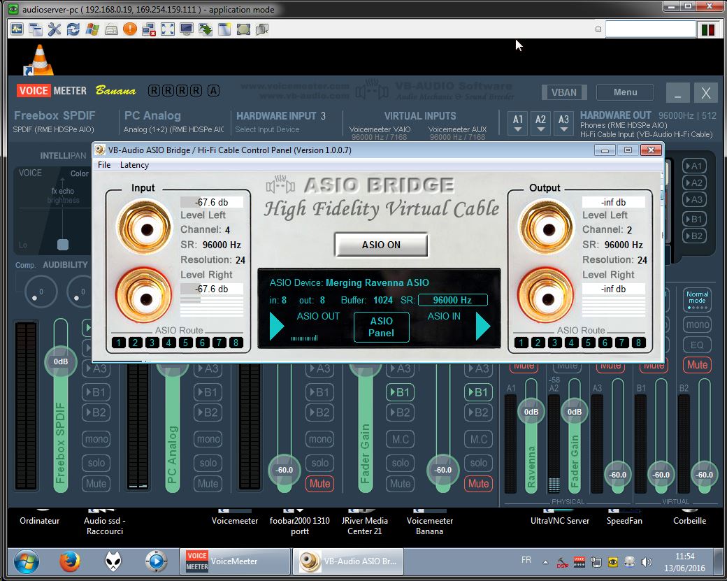

Re: Feature request : sample rate > 96kHz?
This is what it looks like :
There might another problem for me though, even if the sound was perfect : I'm normally using "stereo repeat", and use 4 outputs out of my 8 channel DAC to bi-amp my (2) speakers. I don't see how it is possible to get 4 channels on the output of ASIO bridge, so my guess is 2 (repeated) channels are lost on the way.
(latency on ASIO Bridge is set at 8192 smp)There might another problem for me though, even if the sound was perfect : I'm normally using "stereo repeat", and use 4 outputs out of my 8 channel DAC to bi-amp my (2) speakers. I don't see how it is possible to get 4 channels on the output of ASIO bridge, so my guess is 2 (repeated) channels are lost on the way.
- Posts: 2153
HIFI Cable input can manage 8 channels (here i see that you already get 4 channels) on ASIO BRIDGE Input side (see levels).
and ASIO BRIDGE can also manage 8 first outputs of your ASIO driver (check the configuration/routing of your ASIO device).
REM: you can set the HIFI Cable driver in 192 kHz (in Windows Control Panel / Sound Dialog Box -> advanced button).
according your current parameter it should work ok. it's not?
- Posts: 16
- Joined: Tue Sep 29, 2015 4:33 pm
Just to make sure I understand how configuration works : For the ASIO Bridge Input, I went to Windows Control Panel / Sound Dialog box and chose a 4 channel configuration (4 should be enough, and with more, it seems that Windows might filter the sound on some channels based on the bandwidth of the speakers and I don't want that).Vincent Burel wrote:HIFI Cable input can manage 8 channels (here i see that you already get 4 channels) on ASIO BRIDGE Input side (see levels).
But that configuration dialog is not available for the ASIO bridge Output, it looks like Windows assumes it's a 2 channel microphone maybe. So I don't see where to get 4 channels on the ASIO Bridge output. My DAC ASIO driver is configured with 8 channels, but ASIO Bridge doesn't seem to care about that.
no, it sounds like sound is cut 6 times per second (what I meant by saying "choppy"), but no problem at all if I use the Ravenna dirver as VM Output directly.Vincent Burel wrote:according your current parameter it should work ok. it's not?
- Posts: 2153
BigBen wrote: Just to make sure I understand how configuration works : For the ASIO Bridge Input, I went to Windows Control Panel / Sound Dialog box and chose a 4 channel configuration
for the HIFI Cable input device (playback) you mean - ASIO Bridge is the application placed on the midlle of the HIFI Cable to make a bridge with ASIO device.
BigBen wrote: (4 should be enough, and with more, it seems that Windows might filter the sound on some channels based on the bandwidth of the speakers and I don't want that).
no, there is normally no filtering, and if Voicemeeter A2 is connected to WDM or KS interface of the HIFI Cable, then the link is direct (not passing though Windows Mixer).
BigBen wrote:But that configuration dialog is not available for the ASIO bridge Output, it looks like Windows assumes it's a 2 channel microphone maybe.
again you talk about HIFI Cable output (recording) limited to 2 channel right !
BigBen wrote:So I don't see where to get 4 channels on the ASIO Bridge output. My DAC ASIO driver is configured with 8 channels, but ASIO Bridge doesn't seem to care about that.
no, ASIO bridge is managing your ASIO 8 channels (it's displayed on your screenshot : in:8 out:8). and ASIO Bridge forward the 8 input channels to HIFI Cable output ... but Windows Will limit it to 2 channels at the end (note it works on Windows XP with 8 channels, this limitation comes with VISTA).
ha, very strange! could try to check that your ravenna driver is no used by another app and see if you can change your ASIO buffer size to 512 instead of 1024 ?BigBen wrote:no, it sounds like sound is cut 6 times per second (what I meant by saying "choppy"), but no problem at all if I use the Ravenna dirver as VM Output directly.
