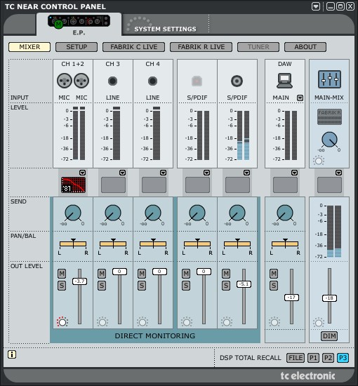

I'm trying to reroute my TV audio that is connected to my konnekt live via an optical/spdif cable. I'm ultimately want to use vm banana too record any audio running through my system as well as manage volumes they the vm mixer.
The issue I'm having is the fact that I cannot hear audio from the TV when voicemeeter is running but can hear it when I have my computer turned off. I can see levels on the control panel for the tc near program, but even though I have tc near wdm in on the second channel selected, I'm getting no audio through vm. Any ideas? Thank you

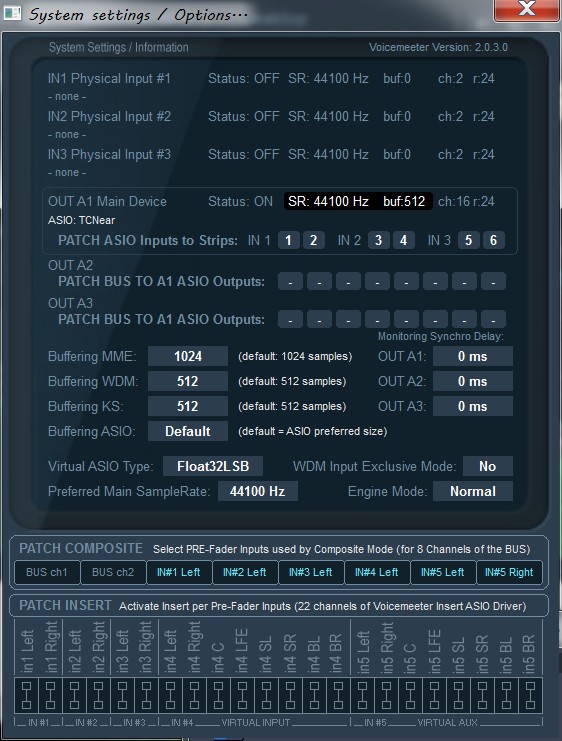

i guess you have to finde the ASIO channel related to your SPDIF / Input... apparently it's not 5/6 because you would get the sound on Voicemeeter Input 3... so configure it for channel 7/8 (in the System settings dialog box: PATCH ASIO INPUT to Strip:)

Hey Vincent I tried that but to no avail. Would you have any alternate suggestions? Thank you

ok, try 9,10 then, let me see a screenshot of your Voicemeeter System Settings / option dialog box...

FYI I'll send a screenshot later today

ok, according the documentation page 55
digital input are on channel 9 to 16
so just have to test channel 9 to 16 in ASIO input PATCH

Awesome! You're the man. Looks like it was channels 15/16.
