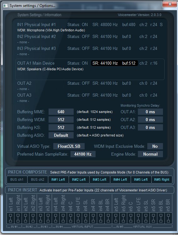

Re: Distorted Audio
Added Image System Settimgs
- Image2.jpg (98.04 KiB) Viewed 24443 times
- Posts: 2144
Re: Distorted Audio
ok, if WDM Speakers (C-Media PCI... ) is not stable, try the KS interface of this device (if present),
otherwise select the MME one (set Buffering MME back to 1024).
