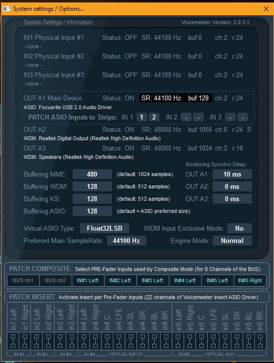

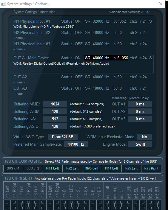

Thankyou for your help erlier today. I have a problem with Voicemeeter Banana, I hope you can help.
Everything works OK if I use the MME driver for my soundcard. But the latency is too high for gaming. I have a powerful PC (6 core i7 CPU, 16GB RAM) so I wanted to try a smaller buffer. Sadly, when I use the WDM interface which allows the small buffers, I get a strange audio distortion. I notice the buffer size is correct, unless I set it to 1024 or less - then, the settings show me that it is using a buffer of 1056. It seems as though it will not go below 1056 on any setting. Even on settings above this (1536/2048), the distortion is still present.
This is only the case when I am using the 5.1 Dolby Digital output of my sound card. If I use the same card, the same optical output, but in stereo mode, there is no distortion.
I have attached screenshots of my settings, I hope this helps. In the screenshot, it shows internal SR 44k1, but I have tried with 48k also and the behaviour is the same.

1- you may set the Engine Mode in NORMAL (swift remain experimental and does not work well with shared audio device).
2- your Realtek Digital output is used in SHARED mode (S) that's why buffer is given by the device itseld and not the preferred one
if configured in 5.1 DTS i'm not sure this device can work in exclusvie mode in fact...
what i recommend is to connect output A1 to a regular audio device that can work in exclusive mode with right buffer size (512 sample for WDM)... and connect your Optical device on output A2 (with WDM or MME)...
output A1 in Voicemeeter is giving the main master audio stream and must be connected to your best, most reliable, most stable audio output device...

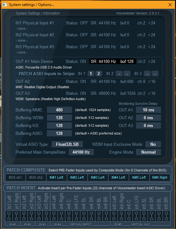

This screenshot is one of many configurations which I attempted, but the same behaviour is seen in normal mode and swift mode.
I tried to use my only other sound card, which is the HDMI audio to my TV, as A1, then, my optical output as A2.
Behaviour is the same as above - distortion throguh the WDM interface, MME has no distortion but high latency.
I have confirmed that no other apps are using the sound card. Not sure why it is in shared mode.

I'd like to confirm that I also experience the same issues as CaptaPraelium.
I am also using the Realtek Digital Ouput, I'm using this on A2 with the focusrite ASIO on A1, however I experience the same issue no matter what configuration I try.
I have tried many different configuration changes.
Changing the buffer size just delays the time between stutters.
I am running Voicemeeeter Banana 2.0.3.1 on W10 x64
As MME - no stuttering
As WDM - much stuttering
