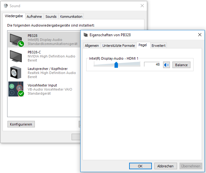

I'm using Voicemeeter to have audio on a multi-monitor setup on both monitor speakers. It works, but one monitor is louder than the other.
I tried to change the audio level through the playback device settings:
But Voicemeeter ignores them.
Is it planned to add audio level settings to the Voicemeeter system settings or is it possible to let Voicemeeter respect the playback settings?
I would donate 40 € if you add this feature to Voicemeeter (so I do not need to use Banana).
Posts: 2156
Re: Speaker levels are ignored
it's pending on device interface you select as output.
WDM/KS will try to open output device in Exclusive mode... bypassing Windows Mixer.
Voicemeeter is providing better gain control anyway.
you might use Voicemeeter Banana, providing 3 thrue independent physical BUS .
(while Voicemeeter Standard provide a single BUS to manage A1 and A2 output device).
