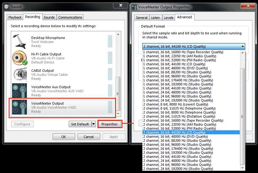

With WIN10 October 2018 Update the default audio format of our virtual audio cable could have been changed to 8000 Hz Mono !?! we don't know why, but we recommend to change it in 44100 Hz Stereo (in Windows Control Panel / Sound Dialog box -> Properties / Advanced Tab).

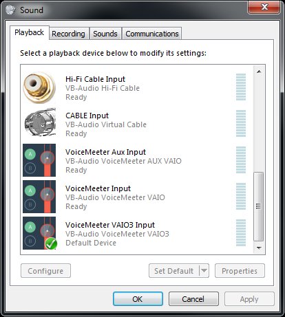

After WIN10 or Win11 update, if you get problem in the sound (stability problem) or you get strange behavior with audio application (bad audio, frozen app), or with device (the device cannot be selected anymore in Voicemeeter) we recommend to re-install Voicemeeter and our Virtual Cable by the following steps:
1- unplug all USB audio device + REBOOT (to restart without USB audio device connected).
2- De-install VB-CABLE one by one + REBOOT
3- De-install Voicemeeter + REBOOT
4- Check your remaining audio devices are working ok.
5- Check there is no presence of our virtual audio driver in Windows Device Manager (in both sections: multimedia controller and audio input output).
6- Re-install VB-CABLE and Voicemeeter one by one , REBOOT after each operation, check your device list in Windows Sound Dialog box.
7- When all is re-installed, re-plug your USB audio device. check again your default playback and recording device
8- Run Voicemeeter and check systray option. Audio should work again correctly.
9- Check that Voicemeeter Devices are correctly named and displayed with right icon:
10 - ReStart Voicemeeter.

Thanks for the heads up. I am probably gonna reinstall it anyways right now as the icons are completely changed over after the update. Also, not sure if its my sound drivers or what, but my mic that I recently got is now overly sensitive, even with using the realtek noise suppression.
- Posts: 2239
Re: Voicemeeter problem after WIN10 update
yes, if our icons have been replaced by generic icons, it means a process has re-installed our driver without using our procedure.
And this also can bring problems, so it's better to re-install Voicemeeter and VB-CABLE in this particular case.
