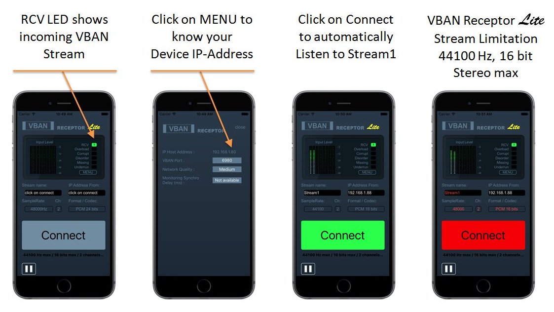

To receive audio on VBAN Receptor Lite application, you have to send a VBAN stream called “Stream1” limited to 44100 Hz Stereo 16bits.
Then simply click on Connect button to get audio on your mobile device.

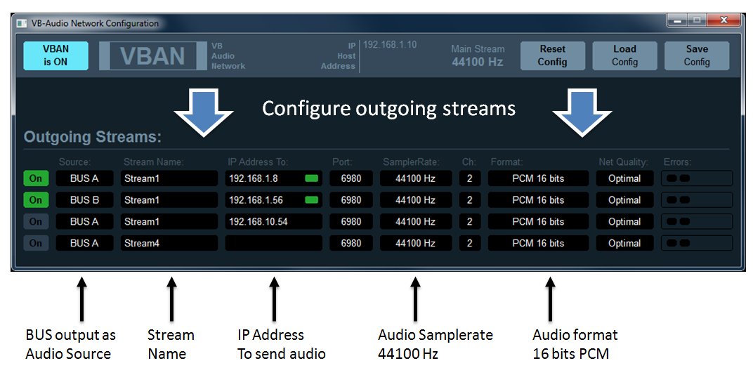

Configuring VBAN Stream is easy to do in Voicemeeter VBAN Configuration page. Just define Outgoing Stream to your mobile devices, set the destination IP Address and rename your Stream to “Stream1”.

Q1 : the RCV LED is green on your VBAN-Receptor Lite ?
Q2: you send a 44100 kHz stream: 16bit and 1 or 2 channels ?
mike@panaweb.co.uk
- Posts: 8
- Joined: Sun Nov 22, 2020 2:13 pm
Re: How To Send Audio To Mobile Devices
A1. yes the RCV is green
A2. yes I am sending 4410khz stream as indicated on voicemeter 16 bit onw outgoing steam 1 with two channels
