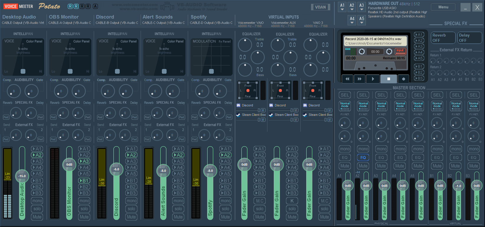

I've been using Voicemeeter Banana and then Voicemeeter Potato for the past few years and recently I've been noticing the crackling sound show up more and more frequently on multiple virtual audio cables and output devices. It's been driving me mad that I cannot get to the bottom of this. Let me explain the setup and then I'll explain the solutions I've tried.
Using Voicemeeter Potato, I have Virtual Audio CABLE and CABLES A-D as my input devices using the WDM driver. I use these to send software audio to different devices depending on what I need. For Outputs, I have my Focusrite USB ASIO driver (for my Scarlett 18i20) as A1, WDM - Realtek HD Audio 2nd Output as A2 (for speakers), and WDM - Realtek High Definition Audio for A3. Everything has a buffer of 512 (including the ASIO device), 48k sample rate, and the Cables all have 7168 internal latency.
In the most stressful situation, I am using all of these devices to route software audio to my speakers/headphones (A2/3) and record audio in OBS by capturing the CABLE Inputs, as well as Reaper using the input channels of the ASIO device to record microphones. In the least stressful situations, I'm playing a video in my browser or listening to Spotify and only using one of the devices. Audio crackling happens in both places, whether or not the system's been running audio through that channel for hours or it just sarted. Sometimes, restarting the audio engine does not work and I have to reboot.

- Posts: 2147
Re: Voicemeeter and Statics, Stuttering, Crackling sound
you my send a screenshot of your Voicemeeter and its system settings dialog box first.

Things have been relatively stable recently, but I haven't actually changed anything. I'm about to go through a relatively stressful production day tomorrow (stressful in the sense of the strain on my computer, but the production itself will be a lot of fun) though so we'll see if it's working. Still, my settings are attached.
- Voicemeeter Window.png (183.76 KiB) Viewed 144918 times
- Voicemeeter Settings.png (97.49 KiB) Viewed 144918 times
