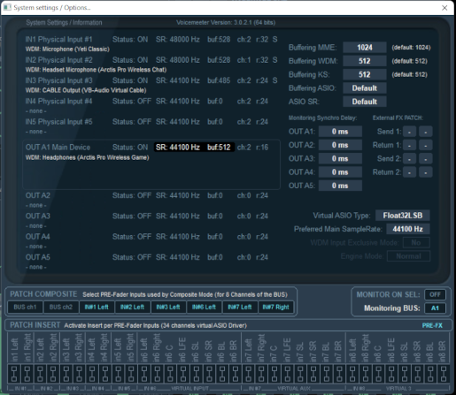

This has become a problem for me as well for some reason. When I load up a game usually, it will trigger the robotic sounding audio. I have to restart the audio engine. Then sometimes it will just keep happening over and over, and now it's gotten to where it happens all the time. I've tried everything I read about in this thread, and nothing helps. I uninstalled all of it and reinstalled it. I put everything as default configuration. If there was a hosting option for me to post my settings screen here, I would do so. I'm beginning to think that this is just a bug that is being left unresolved in the software and that a LOT of people experience this but just get frustrated and just uninstall it and never look back.

- I am using 3.0.2.1, the newest version.Vincent Burel wrote: ↑Sat Nov 27, 2021 11:09 am first of all, you may have installed the last Voicemeeter version
REM: Some game are not able to play correct in an audio device if this device is not the default playback one.
Secondly , you may post a screenshot of Voicemeeter and its system settings dialog box to let me see your configuration.
- Even when the audio is being sent to the default playback device, the problem still happens.
- No matter how small I try to make an image, the forum software doesn't accept it as small enough. Everything is at default settings though, with 3 inputs: 1 Microphone at 48000 Hz buf:528, 1 Microphone at 48000 Hz buf: 528, 1 Virtual Cable at 44100 Hz buf:485. (All WDM)
My WDM output device is headphones at 44100 Hz buf:512.
- I've tried changing the preferred main sampling rate and that of the ASIO SR to 48000 Hz to match that of the inputs, with no improvement. I tried increasing the sampling buffering for WDM a bit, and that didn't seem to stop it either.
- When I remove all of those inputs except for the first microphone, it seems to do OK but that isn't conclusive.

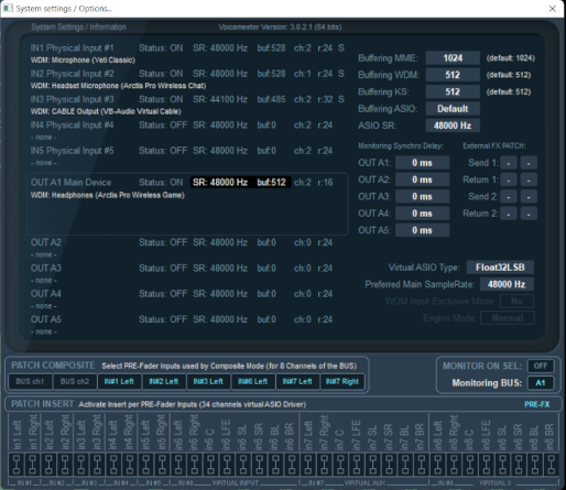

- When I try to add a picture at a decent size it says the file is too large. I have shrunken it down to what it will accept but it is very small.Vincent Burel wrote: ↑Sun Nov 28, 2021 7:26 pm you may use the attachment function to add an image in your post, it does not work ?
anyway, you may let me know:
1- the output A1 Device parameters (samplerate, buffer...)
2- what is your default playback device.
- Main Device = A1 SR:48000 Hz buf:512 Ch:2 r:16 - WDM (Headphones)
- I don't know what the "r" stands for but the "r" on my mic inputs is 24 and it is 16 on my A1 output. I don't know if that matters.
These are the settings that I tried with everything pretty much at default: But these below are my preferred ones because the sampling rates are adapted to match up better, in my opinon:

Seeing as how there seems to be no proffered solution to my issue, I would appreciate this being passed on to the developers/programmers so that they can possibly work on a patch. Thanks.
