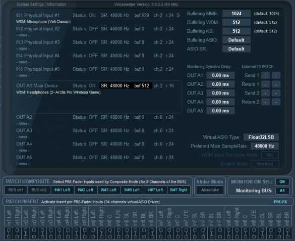

I would like to revisit my issue with the constant audio crashes in Voicemeeter Potato. I am still dealing with this issue. Every few minutes the audio crashes and the audio turns robotic. I have to restart the audio engine. Sometimes this helps for a few seconds, sometimes minutes. Sometimes the PC will do ok for longer periods without problems.
I have gone through all of the articles on the forums about this and tried everything that I could find to try to fix the problem.
All of my sample rates are set to 48000 Hz. I am using WDM. I tried MME but I have problems with people not being able to hear me on some of my apps with it, and it has an even worse lag issue from my microphone than WDM already does (that's another issue that isn't solved).
I changed out every piece of hardware there is in my PC trying to fix this issue: power supply, motherboard, CPU and GPU. The RAM passes diagnostics. I tried a different microphone. I reinstalled Windows from scratch. I have spent literally thousands trying to make one piece of software (Voicemeeter Potato) work.
Attached is my System Settings panel from the program for reference.

- Posts: 2147
Re: Voicemeeter and Statics, Stuttering, Crackling sound & Choppy audio
assuming you tried to use MME or KS interface with your wireless headphone (tried 1024 sample buffer size too).
maybe the problem is simply your wireless device (not enough stable to drive the main audio stream) and you should select a more regular physical device as output A1 instead (like audio device on motherboard).
REM: you may post a full resolution image.
- Posts: 16
- Joined: Sun Oct 27, 2019 8:52 pm
For whatever reason, KS does not show up as an option for my microphone, so I don't use it because I would not be able to match it to my A1 output to my headphones. (Unless you think the mismatch would be acceptable?) The drivers issue is possible, I suppose. The software for the Blue Yeti is done by the Logitech G-Hub software. The software for my Arctis Wireless Pro headphones is the SteelSeries GG software. I am not sure I can forego the Logitech software simply because it controls my mouse, keyboard and speakers as well. If that software is the culprit, I would have to change out many peripherals to a different brand be rid of it. If it is the headphones software, I could possibly see if it runs without it.Vincent Burel wrote: ↑Mon Mar 14, 2022 6:58 am assuming you tried to use MME or KS interface with your wireless headphone (tried 1024 sample buffer size too).
maybe the problem is simply your wireless device (not enough stable to driver the main audio stream) and you should select a more regular physical device as output A1 instead (like audio device on motherboard).
I did indeed try increasing buffer sizes on both WDM and MME. That did not seem to help. Increasing them greatly seemed to sometimes cause more problems.
The motherboard has a built-in Realtech sound card, but it's not good. It has a hum in it at higher volume levels, which I assume is a result of being buried in with the motherboard and the power supply or maybe it is lacking good filtering circuits. I tried to use it instead of the USB audio route when I was trying to figure out a way around the microphone lag issue because I thought that I would be able to switch over everything to ASIO, but it doesn't work like that. It still shows up as WDM, MME, etc. for the Line In input and only the "speaker" A1 would give me an ASIO option. I had hooked up an XLR mic system and ran it to the Line In and was running the Line Out to my external headphones transmitter unit instead of using the USB. I don't think any of it helped with the crashing and robotic audio problem either.
I will try disabling as much control of the mic as I can by the Logitech software, and then if that doesn't help I will try the chop away at the headphones software and drivers and report back the results. I am of course open to any and all further suggestions! Thanks!

- Posts: 16
I believe I found the software culprit that had been interfering with Voicemeeter, and I wanted to share that finding in case any other user runs into this.
I use the SteelSeries Arctis Pro Wireless headset. The software made for it is called "SteelSeries GG", where you can configure your headphones' settings and other things. Preventing that app from running seems to have stopped the crashing of the Voicemeeter engine.
