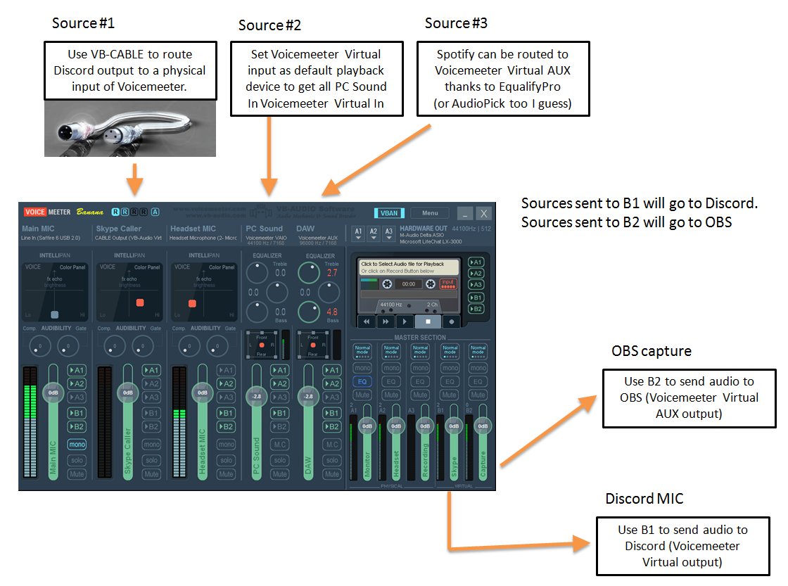

if i understand well, you have 3 sources (so you need 3 voicemeeter input) and 2 outputs (to be sent to applications).
So this can be done with Voicemeeter Banana and a single Virtual Cable.
Does the picture below resumes well what you want to do ?

Yes, and no... not sure actually. lol
I don't have a hardware input, would I put this as the Microsoft Virtual Device WDM then, for put hardware in/output?
Discord would only be used to act as a mic, from a physical location, into the virtual machine. Discord account #1 from the physical location, calling into discord account #2 on the virtual machine. But I want it on a separate channel so I can control it via voicemeeter banana, and obs. So only the audio from account #1 would be coming through, account #2 is basically a speaker, etc.
Only B1 would be needed to go into OBS, I think - as desktop and discord's virtual mic would be going to obs.
Or am I missing something ?

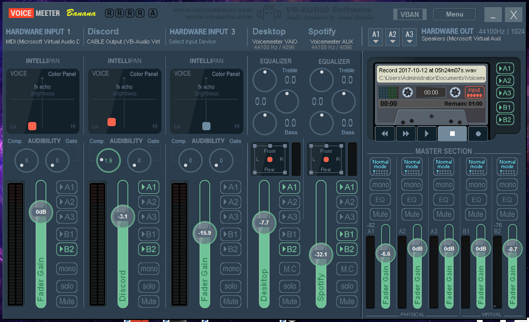

My settings - spotify set to AUX
With this setting, unfortunately, I only am able to hear my mic and not spotify or desktop audio, when I test via in a recording.

Did you level up the slider gain , related to virtual input ?
On your screenshot, Spotify strip gain is set to -32 dB, this can be enough to hear nothing in some circumstances...
Otherwise , what did you set as your default playback device ? (in Windows Control Panel / Sound options...)
