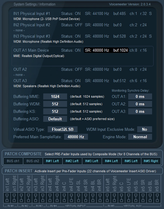

could you please post a screenshot of the system settings dialog box (in Voicemeeter Menu) ?

general rules: in case of problem, go back to default settings.
Your problem comes certainley from this option:
WDM input Exclusive Mode: set it back to NO (there is a warning when you set it to YES).
you may set back WDM buffer size to 512 samples too.
Re: Voicemeeter hangs without explanation

ah WDM buffer, I set it there in an attempt back to solve the Optical Bug on that other post just to see if I could figure out why it was the way it was. Was thinking along Frequency alignment. Couldn't remember about that WDM Input.
Well that is definitely interesting. Seems buffer on the USB mic changed to 485, Analog Mic to 528, and WDM analog speakers to 512. Also, my Analog Mic is seemingly less sensitive. DOH! I can't believe I completely forgot about those changes.
New screenshot...
VoiceMeeter-New System.jpg (204.79 KiB) Viewed 28004 times
Will keep you up to date over the next few days to see if the issue returns.
Posted: Thu Oct 19, 2017 8:14 am
by zapoqx
just updating to say that ya, the fix worked. No issue in these past few days. Also, just updated Windows 10 to Fall Creators Update the day prior and still working well.
