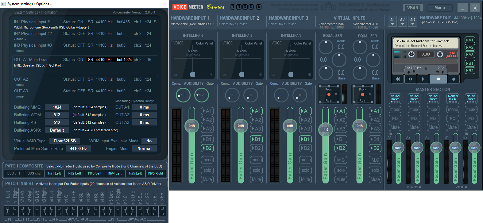

VM B freezes while in game/streaming constantly. The audio just cuts out and I have to restart the application to get it to work again. Its getting really frustrating. I attached my settings and stuff to this. I put it on default, so idk.

its usually a question of configuration: the device selected as output A1

instead of restarting Voicemeeter, can go in menu to make a Restart Audio Engine ?
if yes, it means your device selected as output A1 stops working... after some how many time ?
maybe due USB power management or because the device shut down... or something like that...

you may change the audio interface for this device and see if it helps (use KS or MME instead of WDM for example).
