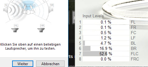

Because they're still "available".
While playing Testtone
While running a game
Running game, set VB-Audio VAIO to 5.1
When I set to 5.1 it seems the audio is played by the correct speakers (BR, BL). I think it's only shown the wrong way in Windows Sound.
