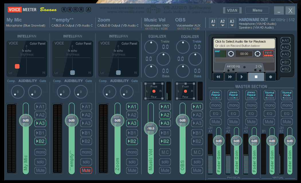

First post in the forum (oh hai!) and a question about how I can get my Voice Meeter to route some of my sound back into Zoom. I am an online Dungeon Master for a great group of gamers and setting the stage with the right music can be the icing on the cake, just like in a movie or play. Currently I use Winamp to play music, which can feed great back into OBS for streaming and the audience, but my players can't hear it because they are in a conference in Zoom.
My question: Is there a way to get the audio being played via my winamp to play back into zoom? Perhaps through my mic channel? Any help is greatly appreciated!
-Eranthius
Here is how my stuff is set up currently:
Banana Screenshot II.PNG (156.48 KiB) Viewed 48903 times

Well... I'm still stuck. Is there any data I can provide and get some help? I'm trying to get my audio (via winamp) to get to my peeps in a zoom meeting.
Thoughts?
Eranthius

Well, let's see. Here is my set up.
I know that i have zoom set up to come into my computer, along with my mp3 player, but how do I get the music from my mp3's to be output back to zoom? I have "cable" options that I'm not using, so I think that's something I could do... I... just dont know how. :P

Ah, now things start to make some sense. You gave us your inputs, but you still haven't told us how your output busses were set up, all I can see is that you're using A1/A2 (headphones and speakers).
You could use one of your virtual bus outputs (B1 or B2) as Zoom's mic input, as you already have Zoom's speaker output sorted. You shouldn't actually need another cable to do that job, as long as Zoom supports a microphone input you can independently set (i.e. not a physical microphone).
You want Audio from bus B2 to get routed back into Zoom to use as a microphone input, so:
  • Open up Zoom's settings, go to the Audio page.
  • Choose VoiceMeeter Aux Output (VB-Audio VoiceMeeter AUX VAIO) as Zoom's "microphone" input.
  • Click Apply or whatever's applicable to close the settings page.
  • Switch to VoiceMeeter Banana's interface.
  • Select B2 on your Microphone input, so it gets routed to Zoom's mic input.
  • Select B2 on your Music/OBS input, so it gets routed to Zoom's mic input.
  • Set your Zoom input to your headphones (Bus A1)and speakers(Bus A2).
  • Turn OFF B2 for Zoom's input so you don't route Zoom's output back into its input.
I'd personally suggest muting the inputs and outputs you're not using so it's clearer which are actively being used. This is not mandatory, I just find it helps me have a better idea what I'm using at the time.
