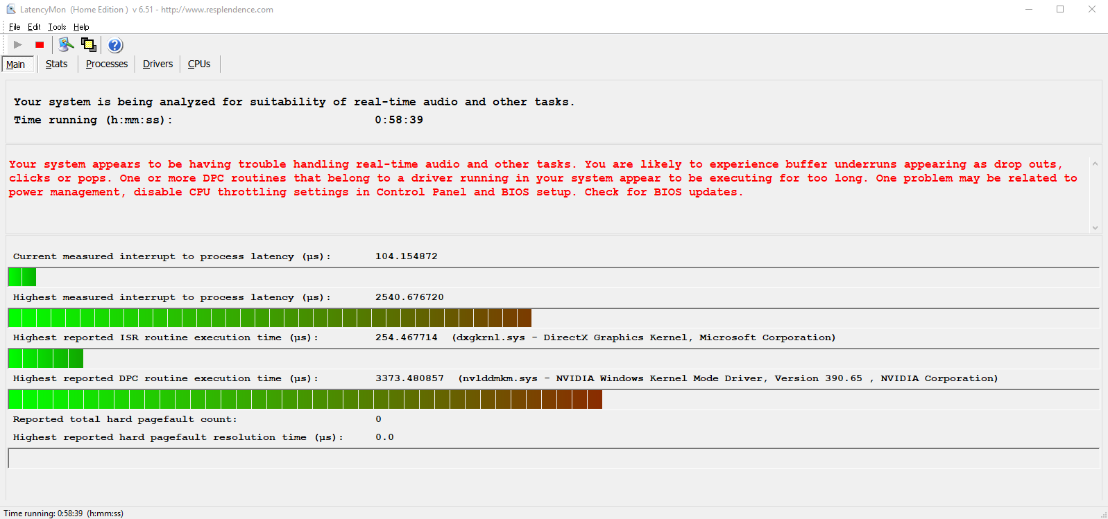

Okay so I've discovered that my nvlddmkm.sys driver, or Nvidia driver, is causing a lot of latency.
Could this be the problem of my ASIO drivers messing up?

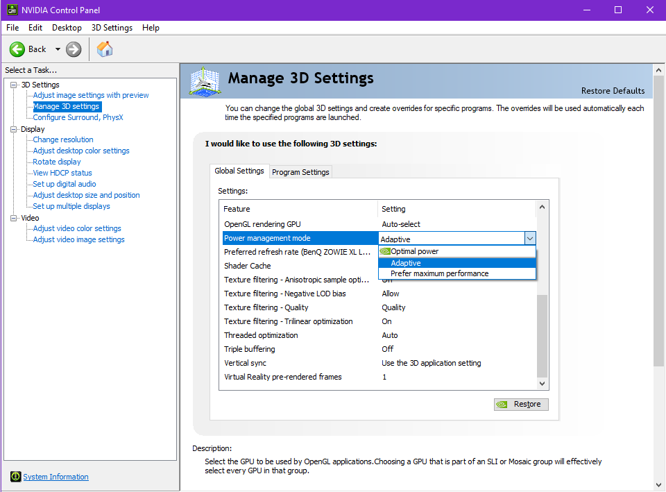

My NVIDIA graphics card has a "speed step" in it, that's a type of bios option that people advise turning off when dealing with CPU related drivers and high DPC from them.

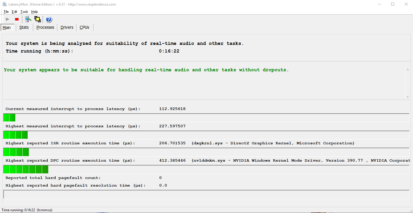

Originally I was on "Optimal", but I set it to "Adaptive" and my Nvidia drivers on average go as high as 527 microseconds in terms of DPC.
Pretty manageable when rocking a buffer size of 64 with all that headroom.
A buffer size of 128 would be securing the fact that any recording or playback would never have a "dropout" from the card.
Here's the option in the nvidia control panel, you can specific this behavior on a global basis, or on a program basis.
And here's the DPCs I'm getting now that I've made this change.

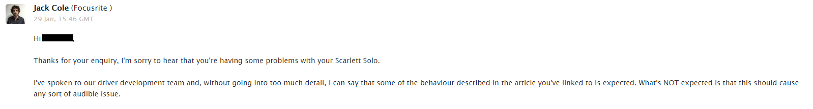

ALSO!: I received a response from Focusrite stating that everything in this thread is normal behavior: viewtopic.php?f=11&p=1191&sid=e35440f85 ... 2e4e#p1191
