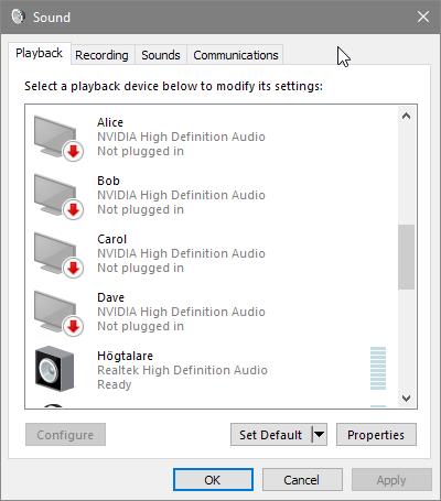

I have four NVIDIA outputs with the same name - "NVIDIA Output":

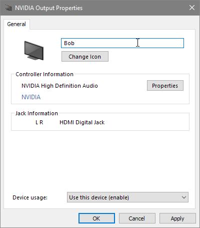

In the "General" tab, you can give it a new name.
The box with the name is an editable field:
The same four outputs, but now with unique names:
