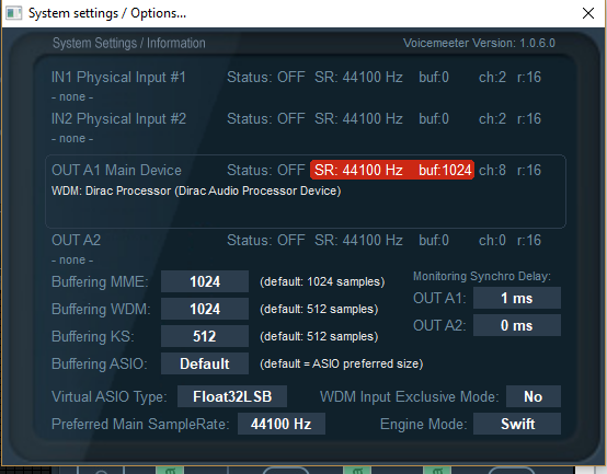

And WDM is not giving an error but would simply not play anything. The device state is Off even while playing:
I tried both Exclusive mode enabled (which I want) and disabled. And both Normal and Swift engine modes - same result.
Other software (like Roon and JRiver) are able to use the Dirac Audio Processor in WDM Exclusive Mode.
How could I troubleshoot the issue?

first you may restore default settings:
WDM buffer default size = 512
Engine mode : Normal
Secondly you can invite DIRAC people to make the test and help us to find the compatibility problem
Thirdly we may reproduce the problem here and see what's happening...
did you try to do the same with Voicemeeter Banana (that will try to open device first in 24 bits intead of 16 bit) ?

Re: Voicemeeter with Dirac Audio Processor
BANANA Worked! Amazing!
Still seems a bit unstable, I suspect.
