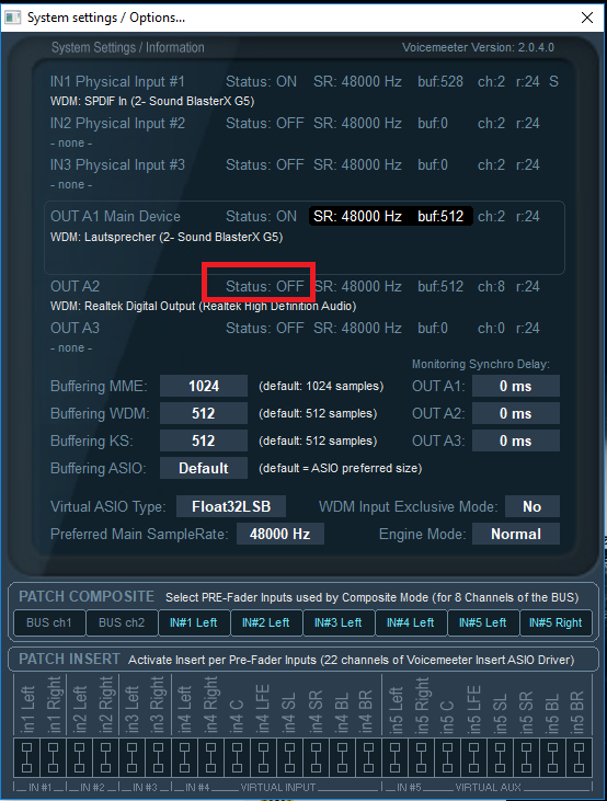

Hello everybody,
I've got a problem with my Realtek Digital Output.
I'm using VoiceMeeter Banana to send 2 Audiosignals at once, one to my headphones and one to my second pc with my Realtek Digital Output.
If I'm selecting the Realtek Digital Output as Main Audio Device in Windows, the signal gets sended, but VoiceMeeter always give me the Status OFF, equal if it's on A1 or A2. How can I set the Status to ON?
Thanks for your help.
Best regards
HmpfReally
Status OFF.png (75.98 KiB) Viewed 5941 times

Re: Realtek Output Status OFF
seems WDM Interface does not work there, use MME instead.
(or it can be due to physical connection, not present...)
