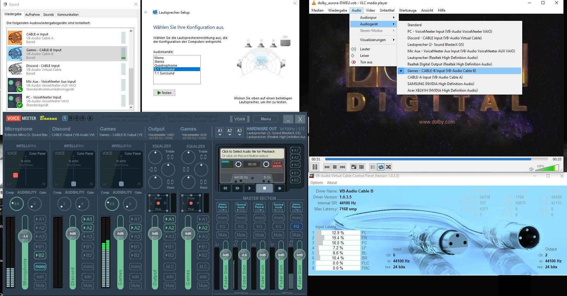

isn't it possible to get 5.1 with V-Cables?
I routet my games via Windows to Cable-B, but the output is only in Stereo. When I switch to VAIO devices, I get 5.1 output. Here is a screenshot from my config and testing with a 5.1 Demovideo.

yes, cable output are limited to 2 channels (Since Vista because there is 8 channels availabe on Windows XP).
if you want to manage 5.1 sound, you may connect directly to Voicemeeter Virtual input instead.
then Voicemeeter will be able to send it to different 5.1 device (and DAW application connect by Voicemeeter Virtual ASIO)
