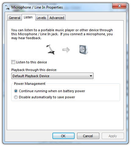

You are Routing the Audio of the VB-Cables to your default Playback device? (checked the box "Listen to this device" in the following screenshot)
So you can hear every audio source at your default Playback device (your Speakers).
But that also means that every program that captures the audio from the default device, now captures your other audio sources (like winamp or discord).
You might try using One of your VB-Cables as default Playback device, which would be your game sound, and tell Discord and Winamp to either use your second VB-Cable or install a third one (the standalone, not A+B one).
Now use the "Listen to this device" option from Windows for all your VB-Cables, but choose your Soundcard Output at "Playback through this device". Since your default Playback device is now one of the VB-Cables, your recording Program should pick the Audiostream from this one, but you should still be able to hear every Audio Source via your Speaker.

Setting my default playback device to the default VA cable and checking listen to device fixed it. I can hear everything but only game sounds get recorded, no music or comms.
