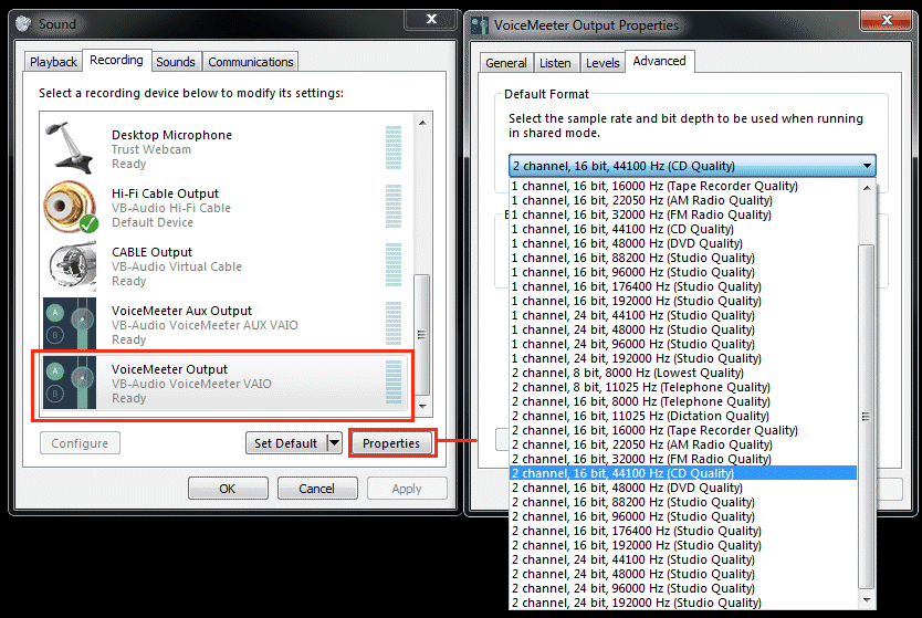

Screenshot of Cable control panel and voicemeeter. https://gyazo.com/9d88c1ab9f1e04b457ff2932bfc300e1

you may reset the default format in the Windows Control Panel / Sound Dialog box.

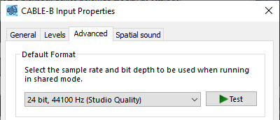

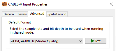

I have Cables A and B set up as 44k Hz audio:
cable a.png (8.24 KiB) Viewed 54644 times
cable b.png (8.87 KiB) Viewed 54644 times

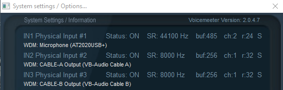

And the result is still the two cables showing up as 8k Hz capable. (seems I can only attach 3 images, so I'll reply to show what MEETER is reporting to me.

Post by llaffer »
8000 Hz.png (33.47 KiB) Viewed 54644 times
Is there any other way to have this work in 44k Hz?
Thanks.
Posts: 2224
Re: Output stuck at 8000hz
As we explained, this is concerning recording devices, not playback devices.
so you may check the default format used by the cable output (not the input).
