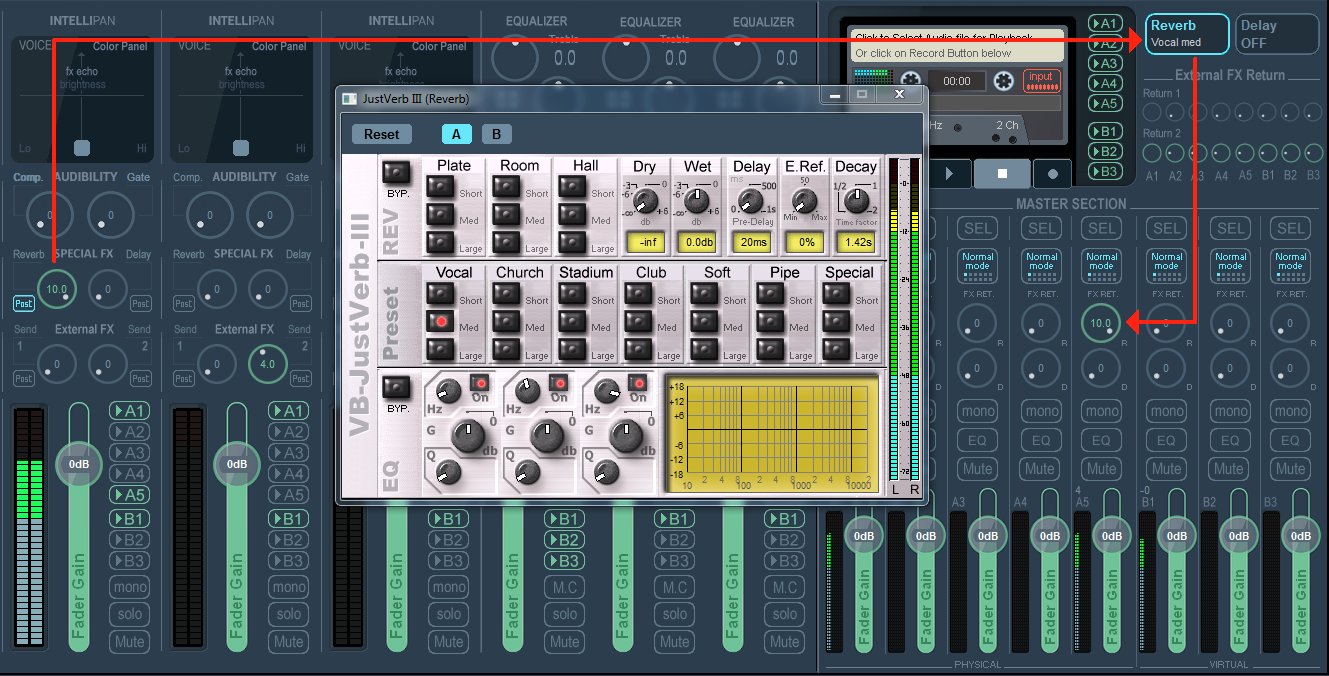

I’m currently trying Potato.
I haven’t figured out how to monitor the internal reverb effects via my headset.
I’d like to add a spot effect to my mic.
I’m using VM and streaming on the same system.
How do I get the effects to work?
Thanks.
Neil.
Re: [Potato] How to use and monitor reverb
Posted: Sun Dec 23, 2018 8:32 pm
simply set the REVERB SEND to max (10.0) on your microphone strip
and set the REVERB RETURN to max (10.0) on the wanted BUS.
