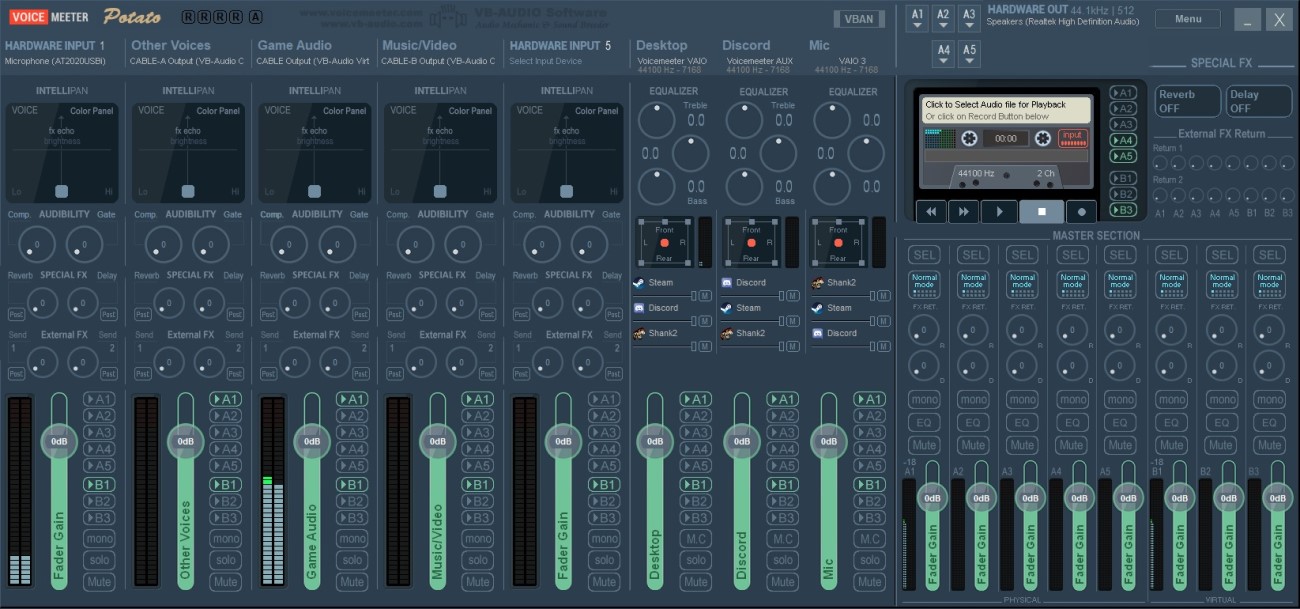

Hello, I've set up VoiceMeeter exactly as is in this tutorial: https://www.youtube.com/watch?v=0rRiHuTqcKo and everything appears to work for the most part asides from 1 issue being a specific game I am running called 'Dying Light'. The game is set up like other games I have such as '7 Days to Die' and 'Yu-Gi-Oh! Duel Links', all being routed though WDM: CABLE Output (VB-Audio Virtual Cable) labeled as Game Audio. All games audio settings have also been configured to what should be correct in the Windows App Volume and Device Preferences, being CABLE Input (VB-Audio Virtual Cable).
For both 7 Days and Duel Links the audio works fine, does not cut out, with the visual bar showing the audio on VoiceMeeter and Streamlabs OBS recording the audio. Only in Dying Light during loading screens when I need to click or press the space bar to continue does the audio cut out. The visual bar is no longer showing audio coming through and the recording of audio on Streamlabs OBS cuts out. After the following loading screen the audio returns and so on. I am personally able to hear the game audio constantly through my headphones still as it appears under 'Desktop' - VoiceMeeter VAIO.

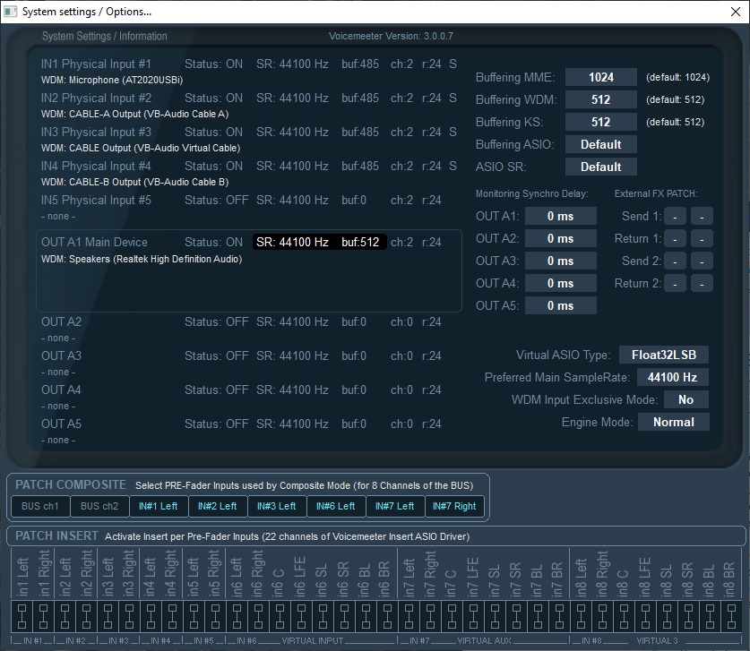

I have not touched the VB-CABLE internal latency. The only things I have done are in the mentioned Youtube link. The attached image to this message should show the current System Settings.

everything seems to be correct in your configuration.
i guess your game is conencted to first virtual input (that you call "Desktop")...
this Voicemeeter virtual input is well configured with 7168 samples buffer size...

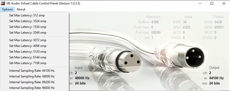

I have tried testing without exclusive mode first, then with it, and now once again without it. It seemed to make no difference towards the situation I am in. The internal latency in VBCABLE_ControlPanel appears only to go up to 7168 smp, not 16K as you mentioned.
I've tried reducing it to 2048, as well as 4096 in the Cable's Control Panel, and then the 'Desktop' sample rate to match that however the issue remains.

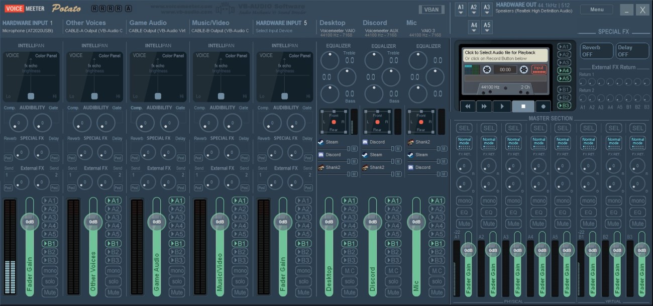

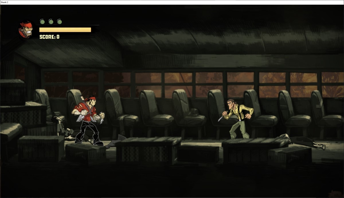

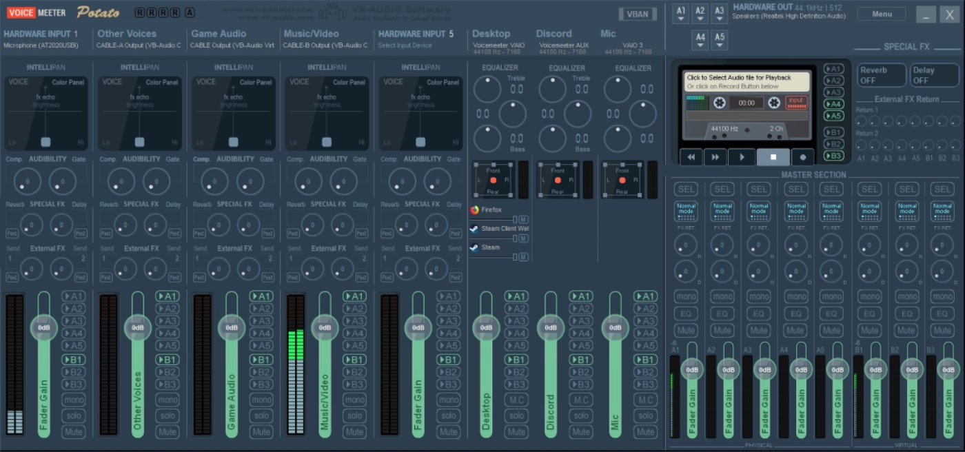

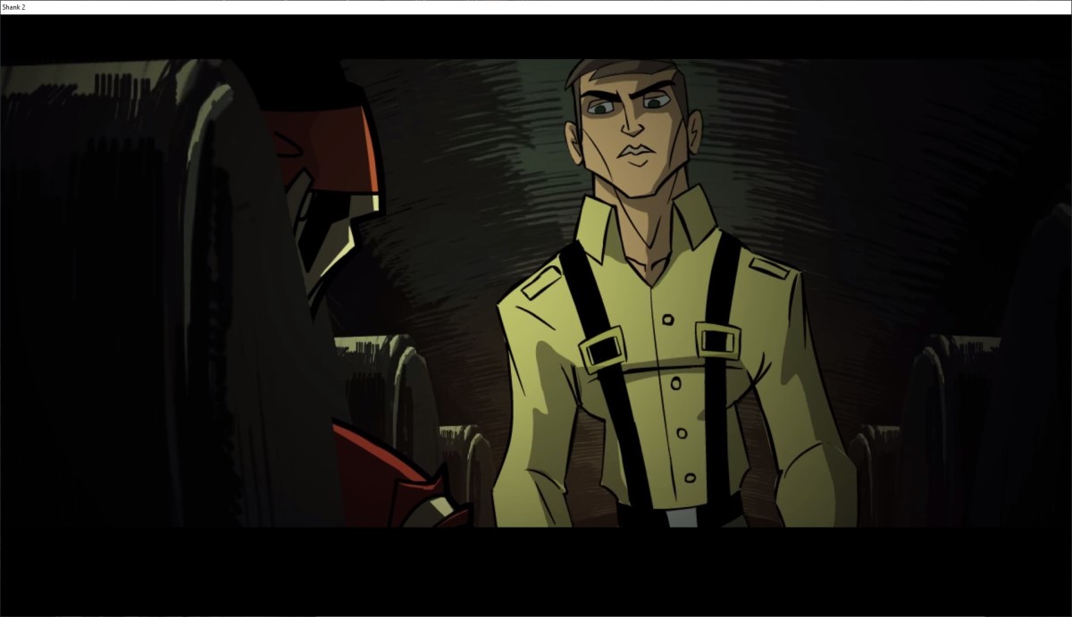

Below are images of VoiceMeeter reading the game audio initially during the cut scene, and then follow up screenshots of the audio cut out with the game transitioning from the cut scene.
The audio system and game running in the above images are working correctly.

Below are screenshots of the game and audio after the cut scene. The audio is cut out from the 'Game Audio' channel, however is still coming through my headphones and can be seen still affecting the audio output of A1 in the Master Section.

lzygmr wrote:The internal latency in VBCABLE_ControlPanel appears only to go up to 7168 smp, not 16K as you mentioned.
Your game is not playing back in the VB-CABLE but in the first Voicemeeter virtual input (these are different virtual audio device). Please run the VBCABLE_ControlPanel related to this Virtual I/O. This program is located in Voicemeeter folder (in your start menu or in your program files folder).
REM: Don't set the internal latency below 7168 samples on VB-CABLE.

I was able to locate and change the correct control panel to a max latency of 16384, restarted the computer and programs, yet still the issue remains of the game audio cutting in and out. Among the testing I found a solution that is still inconvenient being the following;
