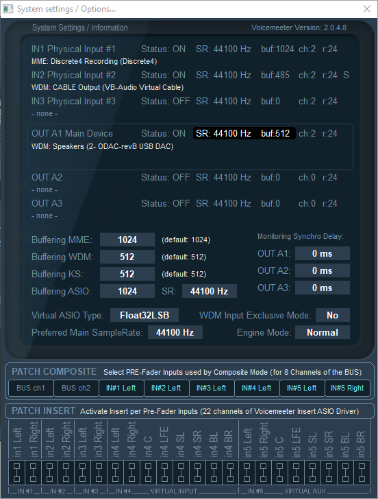

After updating to the latest version of VoiceMeeter Banana 2.0.4.8 my Antelope Discrete 4 Mic Preamp no longer can be used via WDM. It only works via MME. I'm using Antelope Audios USB 2.0 drivers. When I cleared the configs and tried to reconfigure everything from scratch, the application crashes when I select WDM Discrete 4 as input for Hardware Input 1. I'm running on Windows 10. WDM on Discrete 4 was working before the update.

I've attached images of my configuration and system settings in VoiceMeeter Banana.

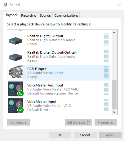

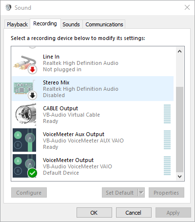

I've attached my sound setting control panel screens. Please tell me if it looks incorrect.
Posts: 2213
Re: Latest VoiceMeeter Banana Fails to Load WDM Discrete 4 Audio Interface
all seems to be ok...
