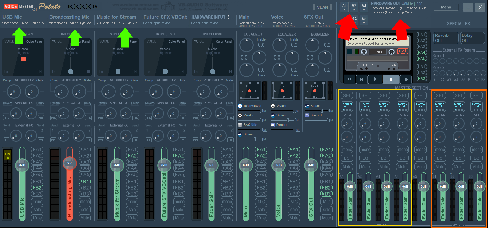

Using this pic as an example of my setup...
I set my Headset Mic as Hardware Input 1. Its audio is fed into VAIO Aux (B2)
I set my onboard Audio Mic port to Hardware Input 2. Its Audio is fed into VAIO (B1)
I used VB Audio Cable to Hardware Input 3 so I can stream music from Pretzel to that (and roughly any music source really). Its audio is fed to A2 (which is my headset) just for me to hear, but in OBS, its also played there directly.
Ignore the Hardware Input 4 section for now cause I'm working on that.
On VAIO 3, you notice I labeled SFX Out. Currently, I have SFX fed into VAIO 3, then have it played out to A1, A2, B2, and B3. B2 is the VAIO Aux so if I'm on Discord, people hear the SFX as well. B3 is for OBS to have the SFX played as well.
In your case, to me, it seems like you'd want either Voicemeeter Banana for I assume more control output audio or you're looking for something else in regards to the Voicemeeter Cable to combine 2 audio sources that doesn't sound like it should be routed that way, but I guess you could.
Also Settings. I don't know if the buffer is something you want to mess with because in my case, it works, but if I'm going by Vincent, I'm probably pushing it for lowering the ms response rate, but that was my intent. You're at 512 from what I see so you're fine there because we don't want to change that until we isolate the issue as you should have more than enough buffer room.
