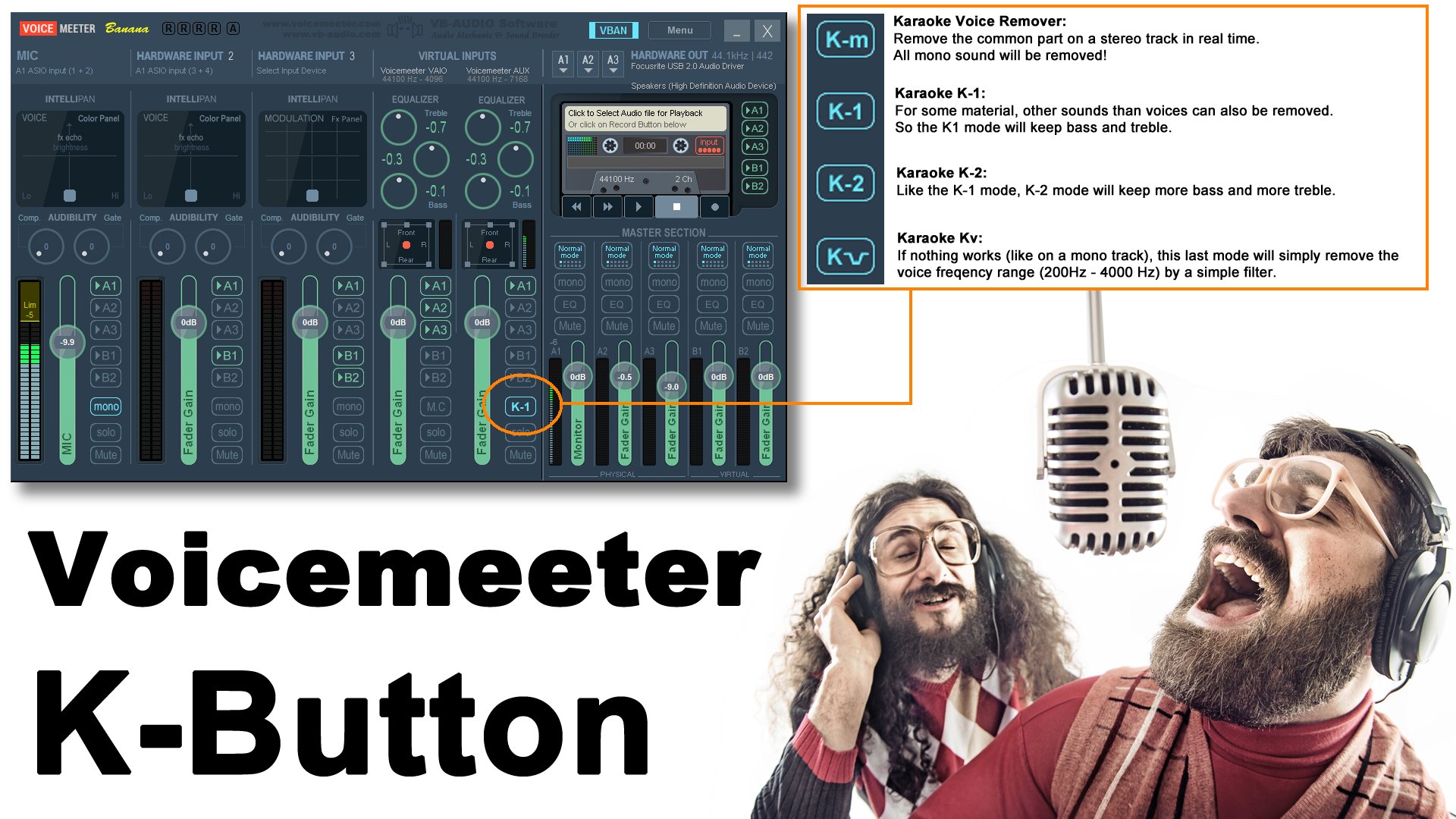

I admit, I'm a little confused about the info in regards to "Karaoke" though. Looking at VoiceMeeter Potato interface, it seems the "K" function as explained is only on the AUX VAIO area where the "M.C." once was, but M.C is still showing on VAIO and VAIO3. Visual mistake? Also, what is it supposed to do? Give more of a native bolster to isolating voices out?

5- the K-Button is on the Virtual AUX only, as it has been explained since the beginning.

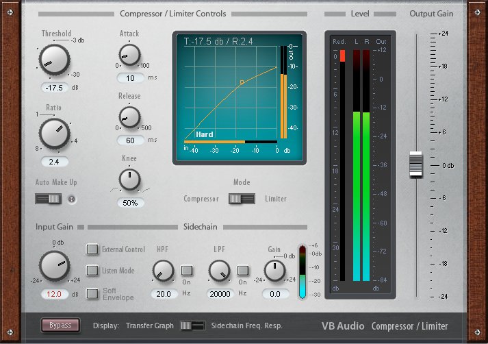

Just want to add: reading 6) reminds me of how much I've always wanted attack and release times for the input compressor/gates.
I mean, yes, I know I could run something like Carla (VST host) and then host another VST(i) and use the FX send/returns. I'm familiar with audio production and it's not alien to me it's just....a lot of work for an attack/release envelope. The built-in compressor/gate have so much potential in theory, but in practice tend to not be not so useful. Honestly I could solve my issues by just buying better hardware and not using onboard audio interfaces but.... It's so close to perfect, and yet, so far.
Would adding envelopes to the channel FX be a possibility?

there is true compressor in Voicemeeter, we just resume it in a single button.
If you need VST just to get a complete compressor, we can think about providing an advanced dialog box like this:

Wow where does that image come from? Something like that in voicemeeter would be amazing :D

well, I developped around a hundred of plug-ins between 1997 and 2005:
https://vb-audio.pagesperso-orange.fr/F ... /index.htm
will think about... implementing a full compressor advanced dialog box in Voicemeeter Potato could make sense...
