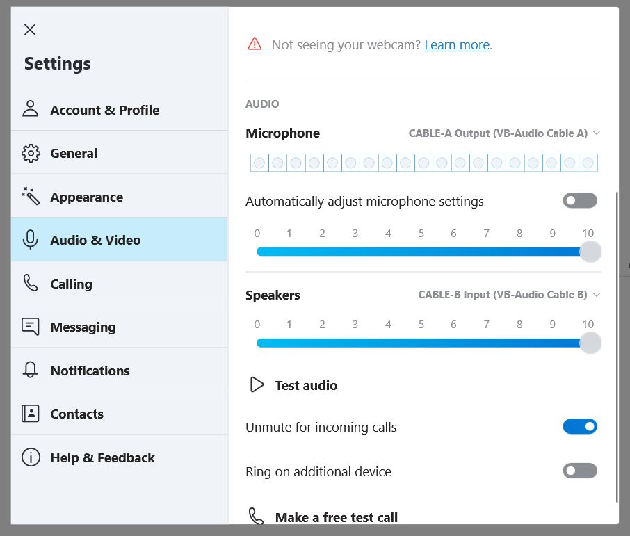

Here is my Skype setting if that helps
skype settings.JPG (73.21 KiB) Viewed 9127 times
Re: Record Skype VM Banana
Posted: Sun Mar 22, 2020 3:36 pm
main problem: you have generated a feedback loop by connecting output A3 to Input 2 (with VB-CABLE B). This makes no sense.
so you may deselect VB-CABLE B on output A3 first.
so the Skype caller is expected to come in HARDWARE input 2 through VB-CABLE B (not use anymore by Voicemeeter output A3)
Since Skype is getting audio from CABLE-A , you may know that all what is assigne to BUS A2 (connected to VB-CABLE A) will go in Skype.
so you must switch off BUS A2 on the Skype caller strip (hardware input 2), otherwise Skype caller will get an echo on his own voice.
BTW: it's better to use Voicemeeter virtual I/O instead of VB-CABLE (VB-CABLE is made to help out in case you have not enought virtual I/O).
